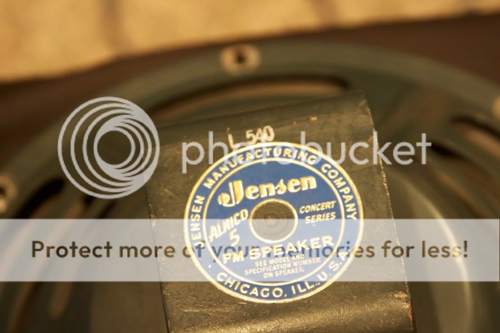

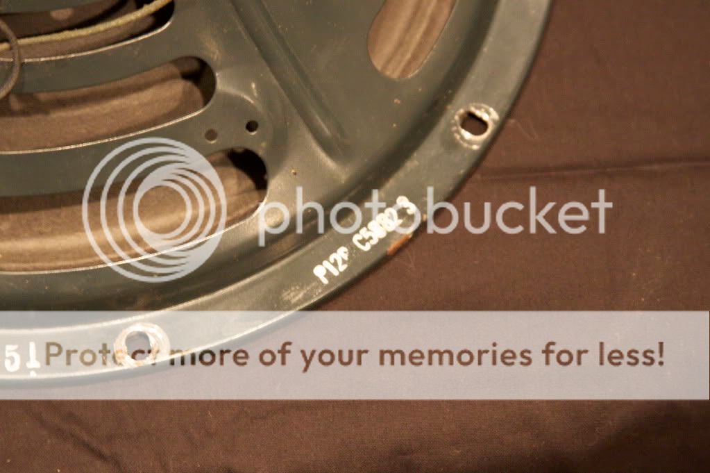

    Ive got this old speaker, but never knew whether its a P12P or a P12R. the letter after P12 is smudged, so i cant really tell. Anybody know?
    Thanks.
    Gettin ready to try it in a '64 deluxe reverb, but would like to know how many watts it can handle!

    pics up.

    It very well could be an "R", which would make it a 25 watt. I've never heard of a P12P. But thats just me...........

    Fender didn't exactly make full use of the Jensen line. The P12P would have fallen somewhere between the 12-watt P12R and 18-watt P12N.
    I probably wouldn't use it in a DR, at least without being reconed for heavier duty.

    I'm not 100%, but the magnet assembly looks bigger than the one on this picture of a 1961 P12Q:
    Bigger than on the reissue P12Qs and P12Rs, too.
    Here is an old Jensen price chart showing the P12N and P12R specs. We can probably extrapolate that a P12P would have been 16 watts and a P12Q 14 watts.

    Yes, there are Jensen P12P speakers.
    I own a 1960 Jensen P12R, and the magnet assembly on your speaker, looks larger?

    That is a nice '55 P12P or so it looks from here by the nagnet assembly size. They are not very common. I also agree with BillM that it would probably live a short life in a BF DeluxeREverb. That amp needs 30 watts of speaker minimum, imo.

    We wll not be able to positively identify the thing until we get a clear side shot showing the innards of that field case. The P will have a larger diameter plug magnet compared to the R.
    Like I said, I do have a P12P here somewhere so I can do a better eyeball comparison once you post a side view.
    Basically if the plug magnet in your speaker is about 1" diameter, it's an R. If the magnet is more like 1.25" diameter, it's a P or a Q.

    That looks like a '55 P12P by the weld on the magnet. It has a 1.5 inch voice coil and was rated, conservativly, at 16 watts.
