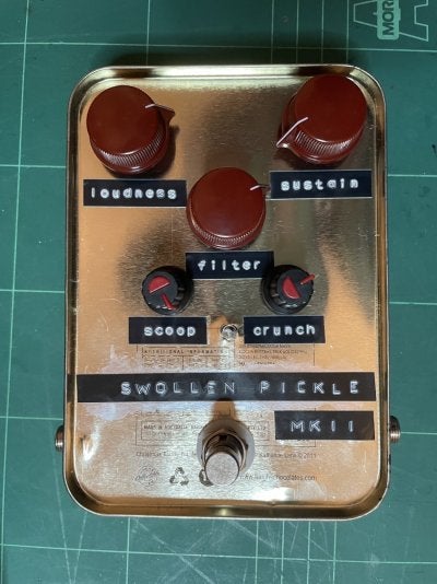

(way huge) swollen pickle mkii fuzz:
5EE29AFB-A9FE-47FD-A1EF-C29EDBA6CAF6.jpeg 9C0CBC38-F0B6-4ED2-93D4-DA499B7986CF.jpeg
1st fuzz pedal build. i never really use fuzz pedals....
but then i noticed a band i like the sound of, actually uses this pedal stacked on top of an overdrive for certain riffs and it adds this incredible hugeness, excessive but pleasant saturation, whilst retaining some structure/tightness thanks to the preceding OD.
I never expected a fuzz pedal to add so much bottom end, it's like a bass button / doom-boom button (when used as described above).
Not something ill use very often, but this build was a lot of fun.
