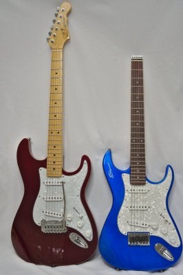

In anticipation of this thing I keep hearing about called "travel" and some upcoming, distant events where a guitar would be handy, I've been looking at guitars that don't take up huge amounts of space, and there are a lot out there. This one ain't cheap, but it ticks a lot of my boxes and is pretty much a no-compromise instrument that will fit in a roll-aboard or a large briefcase.
Build and finish are good, the fretwork is excellent and the cover over the pocket on the back doesn't get in the way while playing. The neck is satin-finished maple with an amaranth fretboard, both of which might cure my lifelong love of maple/maple slathered in lacquer. The strings that came on it didn't hold tune very well, but a set of my usual D'Addario EXL110s took care that.
Once I got used to having to tune with my right hand and not having a headstock, it's been a blast to play. When not traveling, it's going to be a bedroom guitar and it pairs up nicely with my Mustang Micro.

Sorry to resurrect an old thread, but I'm curious about this guitar. How do you like it after using for awhile now?
Have you had a chance to look under the pickguard? Is it routed for humbuckers or single coils only? Also do the tuners turn easily and smoothly? I have Strandberg Boden 7 so I'm familiar with right hand tuning. Thanks!
So far so good. It looks like a guitar, smells like a guitar and plays like a guitar. It hasn't traveled as much as I'd anticipated, but it's pretty much the no-compromise instrument the marketing material says it is. Getting the breakdown/reassembly and right-hand tuning processes down to a science took a little time, but it wasn't difficult.
One thing I've discovered is that the thumbscrews for the neck joint need to be tightened bridge side first for the neck to settle in just the right way. It returns to the same setup very consistently. The strings come up sharp after attaching the neck, but the instructions said to expect that.
I haven't had the pickguard off, but I did check into that before I bought it. They use the same body for the single- and double-humbucker versions and the control cavity is close to the standard routing. The pickguard is the standard Strat shape with a couple of differences in where the screw holes are. I'm planning to build one up with P-Rails, a Freeway switch and a PTB tone stack. The stock pickups and electronics get the job done.
The tuners work just fine. I like that they're tucked out of the way in the back of the body even if getting at them is a little more awkward than where they are on your Strandberg.

For @generic202, I had the pickguard off this afternoon.
The pickup route is HSH. The neck and bridge cavities are routed through where the neck storage pocket intersects. That area has felt on it, so the cavity is closed.
The control cavity is standard Strat. All of the electronics are no-name and the pots are miniature. It all works, though.
The next decision is whether to stay with Strat pickups or have a HSH guard made up and build up something all new.

Quick update on the electronics:
I decided that the P-Rails project was more ambitious than I wanted to do this go-round. So I tore it all back to the pickguard and installed a set of G&L CLF-100s, a Freeway 5B5-01 switch and fresh pots with the G&L PTB circuit. Pro tip: If you want to build one, get the pots from G&L. I looked all over for 1M, reverse-audio-taper pots and nobody else has them.
Anyway, what I got for my troubles is a travel guitar that sounds like my Legacy (which I adore) and has five extra switch positions: N+M in series, N+B in parallel, N+B in series, N+M+B in parallel and M+B in series. Ba-da-bap-ba-bap, I'm lovin' it.
