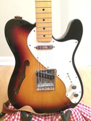

Got it in a trade. Pretty cool guitar with a great U shaped neck. The bridge pickup is actually really good IMO but I'll probably swap the neck pup as its real dark and kinda muddy. The pots are silent which is good but their sweep isn't good at all. If you turn the volume pot down just a hare you lose a ton of tone. The tone pot is weird too. You have to turn it almost all the way down to hear a difference. I'll probably swap those out as I use them a lot. Other than that I'm going to save the back of the neck which is something I do with any guitar that hasn't had it done already.
I think this is part of the MIM classic series IIRC and if so then they've got another gem. I played many guitars in the store and this one felt the best. The PV64 sounded superior but I hated the neck. It felt way too fat for a 60s profile IMO. I'll keep it short as I posted about it in another thread. I'll make a video of it soon.

Nice score!
I recently played one of these and I'm still in shock. I loved both pickups (prefer my neck pickups a bit darker, suited me well) and everything about the guitar screamed \m/ ROCK ON \m/ when I plugged it in. It's on my shortlist of potential next Teles. Congrats, hope you enjoy it!

I have one of these in sunburst also. Mine is a 2009 I think (serial(MZ936....). Ash body. Nice guitar. I didn't like the original pickups though so I swapped them out for Duncan 5-2. This one barely weighs 6lbs. Congrats Gary..

Yeah mines crazy light as well. Idk the year I'll have to check. Mine is ash and sunburst as well. I've never played the AVRI 69' but I can't imagine it's much better. Mine was used and marked at like $499 and I got it for $450 I think. Idk as it was part of an elaborate trade.
It looks BRAND new, I can't find a single scuff. Also came with the cool molded Fender case.
I'll upgrade the neck pup, pots and maybe add a 4 way switch. That and sanding the back of the neck will make this thing a tone monster.

Congrats, Gary!
The center joined, chevroned back looks like it'd have been light even if it was a solid body.

I got one of these, pretty guitar and super light. The figure on yours is awesome, especially the bookmatched back. Stunner!
