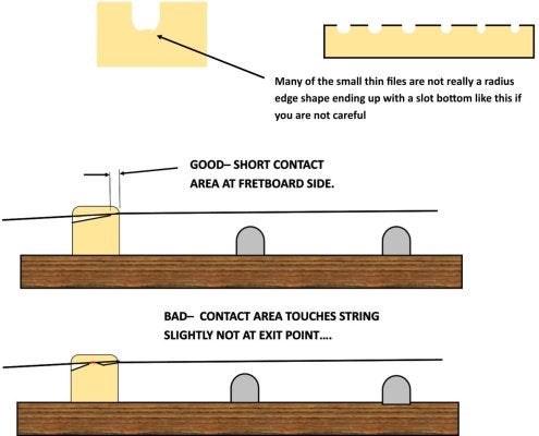

-I would fret the string at the third fret, then check it's clearance above fret 1. (does it still have a bit of gap?)
If it does, you just need to reshape the slot making sure the string touches firm where it exits the nut slot on the fretboard side. Unfortunately you need a really thin file to do this.
