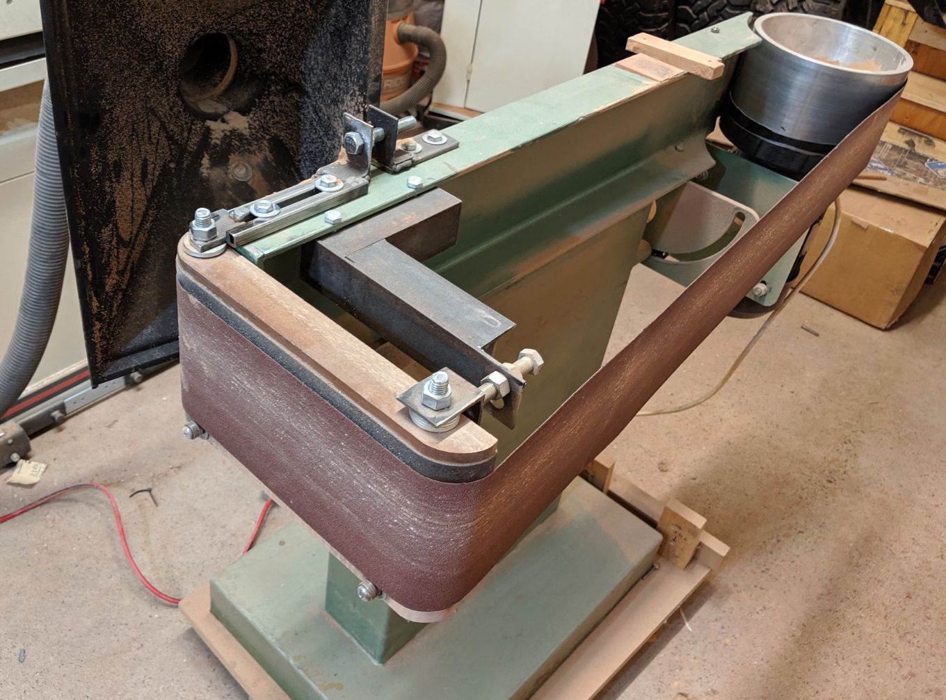

    Neck shape is roughed on a pin router using this jig
    Like that
    The innitial cutting is very close to the final
    but some more shaping and finalizing is required which is mostly done on this combination face/slack belt sander

    The face block sander is used to create the headstock and heel transitions
    and the headstock back (as well as thicknessing).
    The thicknessing initial size is 0.6" and I will finalize later..
    Note the different color of the Cuban Mahogany being densier and darker, here against a Khaya Bone neck
    The profile (or neck shape) is done on the slack belt area.
    This area is very flexible and "giving" but I still do it very carefully and try not to sand the skin off my arms.
    I learned this from Marvin Lamb who showed me how he did the 50's Gibson LP's necks back in the day when I met him at the Kalamazoo factory a few years ago.
    A lot of the "right" 50's shape and feel comes from this irregular method and it is not as straight and perfect as the modern rolling method which is... well... too straight (-;
    A big part of the old necks feel comes from them not being "perfect".
    Only issue is that the sanding is done across the grain leaving horizontal marks
    and I need to manually sand it with the grain to remove the cross grain scratches that may become an issue when finishing the guitar later on..

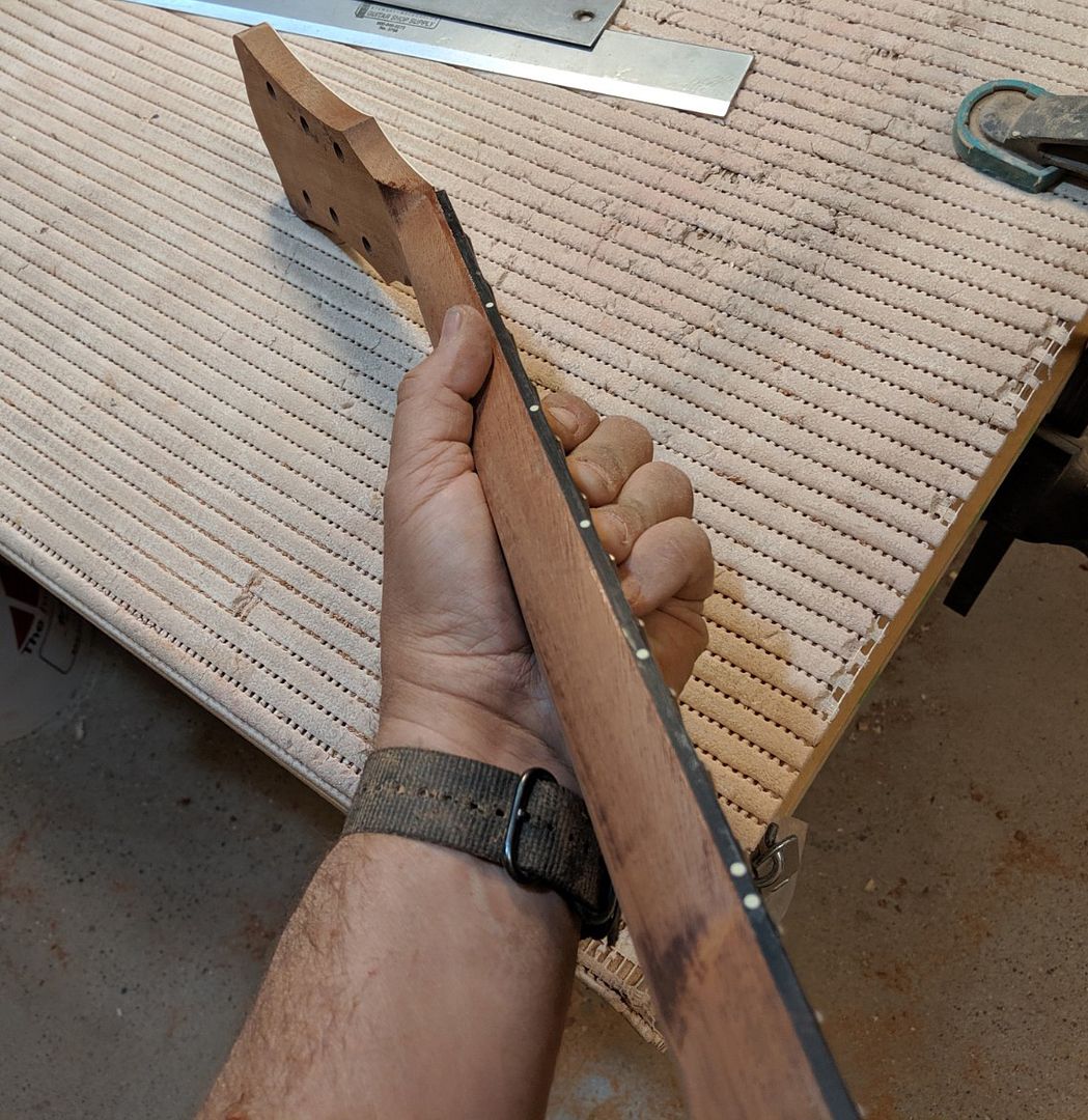

    Once the neck is shaped I tune the headstock tap tone. The way to do this is by holding (pinching) the neck at the nut location and tapping the headstock.
    A big part of the tone is coming from the headstock which is basically a plate at the end of the neck.. I slowly remove material from the back until I get the desired tone and level.
    For the Lyra I'm going for a lower and deeper note to match with the semi hollow body to emphasize the warmth and depth of the rich lows.
    I ended up at about 0.5" which is 0.1" thinner than the Bone line spec (0.6") and you can see the difference here
    Looking nice...
