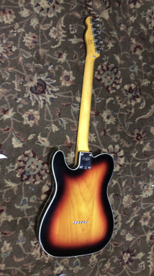

    I must be off on the date of mfg. Too bad I can’t read the SN on the pic on my phone. To be honest, I had not taken the bridge off my new indo BSB to check if there is a sticker on the back of the pickup that matches the stickers on the backs of the toneriders -as is the case with the Chinese CV guitars. I don’t know if my preference has to do with the wind, a defect, or what. My CVC bridge pickup is thinner sounding- even when it is raised closer to the strings. And it feeds back easier than the BSB. I have tried a few remedies short of redipping it in paraffin and it still tends to feedback. I have a spare bridge pickup from another CVC - been meaning to drop it in and see if it takes care of the feedback issue, but I have too many projects and not enough time.
