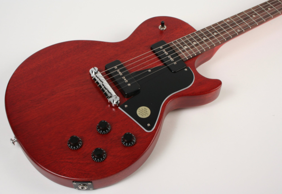

I found that a capacitor in series with the neck pickup works, the smaller the cap the more bass gets cut, BUT because caps alter phase you might find that your middle position gets affected and not necessarily in a good way. A cap that's small enough to get a good tonal balance between the pickups might add a hint of that out-of-phase sound when both are on together, ruining the beauty of the middle position. It's a compromise.
I solved the problem by taking a fat old Dimarzio P90 that ohmed out to around 9k (pretty high for a P90) and unwinding it in steps down to about 7.2k. That cut the bass & muddy low mids and boosted the sparkle factor. That's what's in the avatar guitar now, along with a Parsons Street bridge p'up at 8.2k.
Lindy Fralin sells 15% underwound neck P90s, but the mini humbucker solution is what I found worked best in my LP Studio.

I love the sound of my guitars neck p90 in the middle and bridge positions, but the neck and be a bit too dark. Are there ways to brighten this pickup, or would putting the bridge p90 I have from the set in the neck help? Thanks.
Other than that - a treble booster is worth trying too

Am I too late to the party? The dry-switch feature on the early Yamaha Revstars might be ticket. It doesn’t brighten the tone, it cuts the bass. I had Gibson 498/490 pickups in one and was really impressed with what it did to both humbuckers. This mod works with P90s and it doesn’t look too complicated to build.

why not try the G&L PTB tone stack?
Maybe you could only use the bass cut part
ore make a test setup, dial in to you get your sound.
measure pot resistance and buy a resistor and caps and build them in the guitar for only that pickup

If you're at full volume and playing with not too much dirt, try turning it down (on the guitar, not the amp) about 25%.
With some pickups this can weaken the top end, but with P90s it can drain off the mud and add some bite. I have been doing this with my P90 Revstar and it's a real revelation.
This makes a lot of sense. The P-90 style pickups Guild used in their earlier guitars had lower output than the ones Gibson used and they had more twang/less sludge. Dialing back the Volume does something similar, though not exactly the same. Thanks.
