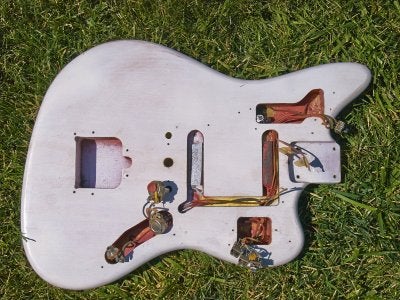

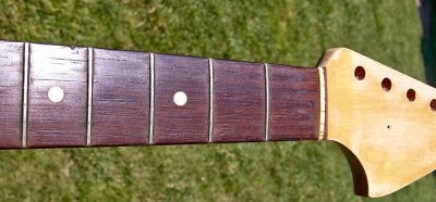

And a few more pictures of this 1965 Jag. Like the FUNKY strings, never heard of them. As you can see the body has been completely sanded and sealed. The neck was also sanded down as I believe the headstock was red at ton time and that's why the logo is gone.

Congrats again!! Glad it found a happy home. I stand by my fiesta red recommendation (the overspray looks more like that to me in the pics anyways, but hard to say). Surf green would look killer, too... especially with that rosey rosewood.

The remnants of red in the control cavities look like Candy Apple Red to me.
This might be true. Hard to tell, and admittedly, I’m looking at it on my phone. This isn’t mine, but it’s a 65 fiesta red...
Lighter shade of red than candy apple. Flatter, no sparkle. Shades of coral or pink. This picture shows that pretty well to my eye.

From what I can see, It’s all there except a few screws/nuts/washers and maybe a string tree (get the Fender Pure Vintage one if so). The same sizes for all of those are used on modern guitars. You can buy cheap on eBay.
I’d definitely restore it to a faded Fiesta Red with matching headstock, maybe a light relic, although that might not be the original colour as I see some red overspray on the cavity shielding.

Pretty hard to tell on the paint as most is faded overspray, but it does resemble that Fiesta Red. I will have to take a more positive look to determine the correct color. I was hoping that the SN would contain a number to reference the color for a 65. The tuner holes show red in the cavities so the head stock as your pictures show will take a bit of paint when it comes time,

On this project I decided to start with the neck for a clearing of the fretboard, light sand, oil, re-fret. Tested the truss rod and has little change in the relief of the neck. I do not hear any rattles in the neck and if screwed outwarded at the screw end looks as it will come out, did not go that far. The only clear coat left on the neck is at the heel were the date and some kind of stamp is found, so will leave that area on its own. The frets were removed today with good success, no real chipping but did show signs of glue use. The frets are very thin almost tiny. Any one know the type and size of the fret wire. Had some corrosion on the underside on one or two frets so was not in a home at one time may of been in a storage building. After 54 years no surprise. The guy I bought this Jaguar from says it was I in the closet as it is now in parts for 25 years.

Good news, the color was Candy Apple Red, and that's what it will be again. Found a good source of color under the brass grounding platform, also found what looks to be the original resistance checks or phase drop of the pickup when put in, barely see it 20 / 16. I did a resistance check of both the Jags PU and one was 6.13 and the other was 6.62. The phase drop with hot to hot and ground to ground shows a down drop not sure of how much. I will research the original readings from Fender.

Howdy, well I have just found the product number for the gold base paint that points to what was most likely use by Fender - Firemist Gold, that was a Cadillac color. My friend the painter sealed and primed the body and headstock in peroration for the paint. Last week I took about a two hours dry sanding smooth with 600 - 2000 grit sand paper. Both body and neck are ready to go the mile for the new CAR paint.
Due to the PO had sanded off the neck headstock decal along with most of the natural yellowed lacquer from the neck itself I am at a point were I am wondering if I should re-lacquer the neck first with a clear yellow lacquer from Reranch or paint the headstock first. Its like witch came first the chicken or the egg:rolleyes:
Took some time with the electrical parts including the PUs that all needed a bit of a cleaning while maintaining the aged look, so far that has been completed. The old tuners were soaked in a lite cleaner to remove the old grease from the insides and re-greased with light grease with a syringe and needle to contact the gears in each one. Much better now than before.
So just trying to figure out the neck right now, I may go ahead and paint the headstock then latter respray with a lacquer.
I am still looking for a good decal for the headstock before a clear is shot on, one the will take the clear without cracking from the clearcoat. Oh yeas also looking for a replacement bone nut for the neck as the old one just was toast.

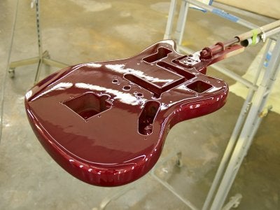

Update - all parts found and ready for install on newly painted CAR. 2- coats of Shoreline gold, 3 coats of CAR, 3 coats of clear. Will brush paint the neck pocket.

It is a good color, you can see the gold flake on the corner. Cant wait to pick it up on Friday as of course it is curing a bit. Will buff it out on Sunday. All the parts are cleaned and polished and lubed but all still orignal, even the wiring.

That’s gonna look so rad with the matching headstock. I am candy apple red with jealousy.
