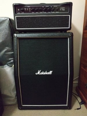

    Well, I picked up my VHT D-fifty yesterday and after a few hours playing it, I knew it would be a keeper.
    Today I got stuck into some tweaking and aesthetic mods.
    As is my usual modus operandi, I opened it up and went thru it to see what needed to be tweaked.
    For those that don’t know, this VHT is a hand wired, eyelet board in the style of a Dumble ODS amp. Designed in the US but built in China at an incredibly cheap price. This is my fav kind of product – great design and performance, with quality where it counts but some shortcomings where it doesn’t matter to me.
    This amp perfectly fits that description. Nicely laid out, very well soldered, good looking components, and a plywood cab that is solid and well designed.
    But, there are a number of small finish details that are a bit crappy. This stuff never bothers me in the slightest because I luv to tinker and having stuff to fix n tweak suits me fine.
    First up, I knew from research that the wiring in the footswitch was done wrong at the factory and needed one wire moved to a different lug. Easy done.
    Then, I never liked the look of the front grill cloth so I knocked up a new front panel that was more to my liking.
    While I had it open I noticed a rather odd thing. The power transformer was lifted up off the chassis with multiple nuts under the mounting bolts. That was not such a big issue, except that one side had 3 nuts and the other had 4. Therefore the transformer was tilted. Anyway, I took out a couple of the nuts, and all good now. Nothing more than my OCD wanting everything looking right.
    Interestingly, a nice touch for tweakers is the bias adjustment control. There are 3 test points on the top of the chassis, and a pot for adjusting. I haven’t played with it yet, other than to mark its current position for future ref.
    Another owner suggested that the handle was attached with screws rather than bolts. Def not the case – big bolts and T nuts, although the handle does seem pretty cheap n nasty. Easily replaced if necessary.
    I also swapped out the small rubber feet for some nice big fat ones. Just my OCD.
    Now my only problem is, what to do with all my other amps? This D-fifty is so incredibly versatile I think it is going to replace most of them.
    Sound
    The 3 tone switches work really well to change the character of the amp and make it very versatile. You can add/remove brightness, warmth, mids, clarity, punch, and go from country, to jazz to rock and thick OD.
    The EQ knobs are a lot more subtle but still useful, and you get a Presence control along with the usual Treble, Mid and Bass.
    The OD is a little more challenging to get right with 3 knobs to tweak along with a Vol and Master Vol. The function of these controls makes sense but I usually prefer very simple setups so it’s a bit of a learning curve to get just right.
    This amp is actually single channel but it has a switchable OD stage and uses an OD level control to keep the volumes in sync.
    The versatility would make this amp great for studio work or playing in multiple bands with different styles. It doesn't seem to be a particularly loud 50 Watts either.
    I’m running it thru a Marshall 2 x 12 vertical cab, with a Creamback and V30, and it sounds great. Creambacks seem to be the popular choice for Dumble style clones, and V30s frowned upon. So I think I've got it just right

    Yes, my first VHT but I have been looking at their other models for a long time. Only I have plenty of small amps. When I saw this one I just jumped at it. As I mentioned, I like their philosophy of US designs but Chinese manufacture.
    I think the boxy look is just the pics/lighting. The White piping really stands out in the pics but not so much in reality. I thought the same when I was looking at the pics but it looks great in reality. The beige grill cloth it comes with is pretty horrible - looks like hessian bag material.
    It came with Ruby power tubes and I did swap out the V1 pre-amp tube with a JJ 12ax7, but I haven't had a chance to test it yet.
    The pre-amp tubes are Chinese, which are fine if you need to brighten up your amp. My cab is quite bright already so I thought I'd try the JJ but it actually sounded pretty nice even with the original 12ax7 so I might put it back if there's no substantial difference.
