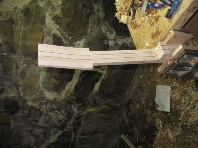

Neck Construction
I thought I'd start with the FB. It was fairly straightforward, and I cut it to accommodate jumbo SS frets.
The other photos show the neck blank as it moves from glued-up, through tapered, to rough-shaped. I tapered by cutting to the line with a backsaw, chiseling out the waste, and giving it a quick shot with a block plane.

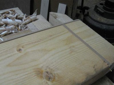

How to flatten and thickness sides... with handplanes!
If anyone's sick of hearing me rave about handplanes, now's the time to tune out.
I've been lucky; when the shop program at my school closed down, I inherited several handplanes. That, plus the few cheapo ones I already had, supplemented by some yard-sale and antique-shop gems, has left me with a great many wonderful tools for a great little outlay of cash.
A million woodworking references cover the process of flattening and dimensioning stock using, first, a coarse scrub plane, and then a jointer plane to get rid of the scrub-plane marks. I took a few pics of the process. My uke adventures had taught me that the hardest part about thicknessing stock down to 2mm or so is holding it in place while you plane. So here's my setup.
First pic are the sides, resawn from some Home Depot maple. I'm a bad resawer, which is okay since I'm a good planer. You can see how wide the mouth is on my cheap Sears handplane; I use it as a scrub plane, having cambered the iron a great deal. It's delightful. Then I show my thicknessing jig, made from some MDF and a piece of wood the previous homeowner left me.
Picton
Feb 7, 2009
2,666
50
Reading, Massachusetts
Flattening, cont
You flatten stock by planing on a diagonal, or straight across. It's not hard work as long as the plane is sharp, and I timed the process: from the time I turned on my cheap little bandsaw for the resawing, through the thicknessing and smoothing, to the finished product took around 2.5 hours.
The pics show my progress: note the diagonal scrub-plane marks, later smoothed by a longer and more finely-set jointer or jack plane. Be warned: if you do not get the sides dead-flat, the stock will go flying as you try to plane it.
In the early stages, the stock was too thick to use my jig reliably; that's what's with the ghetto-looking combination of clamps and masonite that was meant to form a planing stop.
It did not go well.
So I suggest resawing more carefully than I did, in order to avoid having to remove quite so much material with the scrub plane.
The last pic is a "before-and-after" look at what happened to the two sides during thicknessing. I should point out that, of the 2.5 hours total, the actual handplane work took just a shade over forty minutes, with occasional beer breaks.

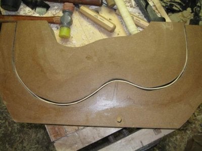

Bending the sides: therapeutic
Before I bent the side of a musical instrument, I presumed it would be a pain. Having done a few, I find it relaxing. My "technique" (such as it is) is pure Bogdanovich; he wrote an outstanding book on classical guitar building. Many people build massive, partially-automated side benders that work spactacularly, especially in a production setting. But the plywood, springs, and metal heating blankets these contraptions use cost money, so I'm left with...
1. A side mold made of stacked, shellacked MDF.
2. A side bender made of MDF, a lightbulb, some bad wiring, and a soup can (Progresso, not Campbell's; only Progresso cans are big enough to clear the lightbulb).
3. Lots and lots and lots of clamps.
Behold! the side bender. The lightbulb is 100 watts, and the soup can portion slides off to accommodate bulb changes. I assumed this thing would fall apart soon after I made it, but I've been pleasantly surprised by its strength.
