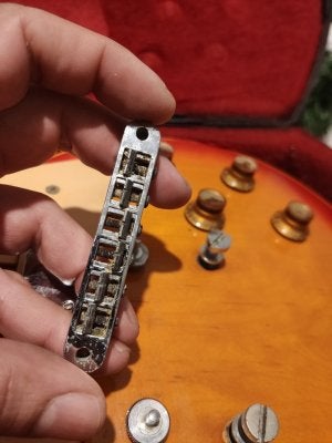

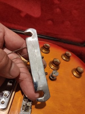

The 78 LP came to my hands seven days ago.
A guy call me a month ago and told me that he found a guitar in his stepfather closet, his stepfather mentioned the guitar after a long discussion they have about music instruments, they both are drum players and the older guy mention that about 20 years ago he exchanges some drums with a guitar and some cush.
The guitar is the one above, it was seating in the dark for 20 years, I thought that this was stories that grandfathers were telling to kids at nights to fall asleep and see nice dreams and no one of those stories was true...

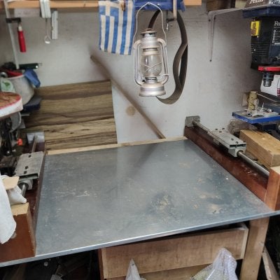

When the guy call me a month ago, he said that he wanted to bring the guitar for a setup, I ask if I had the permission to take some measurements or even better copy her, and he said : ''Sure that's not a problem".
nickhofen
Nov 8, 2010
4,456
HELLAS, Land Of Heroes .
So I dive at my scrap part pile and make a duplicator or copy curve or whatever it is called, lol.
The two last photos show the index point that traces the object you want to copy, for each router bits you use you have to have the identical index point.
I call the index point a stylus . For inletting I make both oversize and undersize stylus, depending on what I want the cutter to do .
There's a nylon called delrin that works really well.
