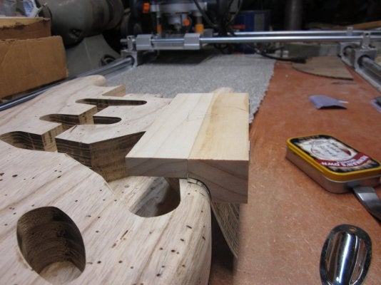

With all of the discussion about routing and sanding the body perimeter, I'd like to show some of the methods I use for hand sanding, in particular - sanding the body's perimeter
It seems that no matter how fine the grit is on either the belt or the drum sleeve I use on my ROSS, it still takes a fair amount of hand sanding to get the perimeter of the body ready for a finish - especially the areas with end-grain

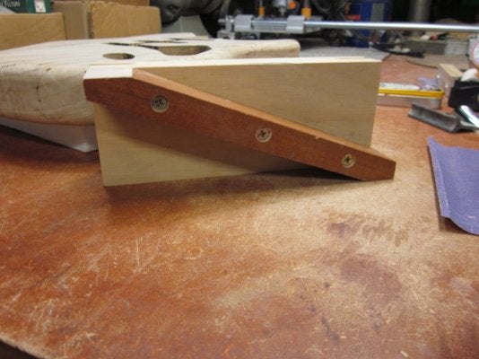

I like to keep my guitar sides perpindicular to the top, and keep an even and consistent radius on the edge round-overs

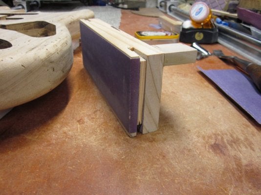

I make up some simple sanding jigs to help me do that, and make the job go a little smoother - hand sanding seems to be one of those jobs that most of us aren't too over-eager to tackle ;)

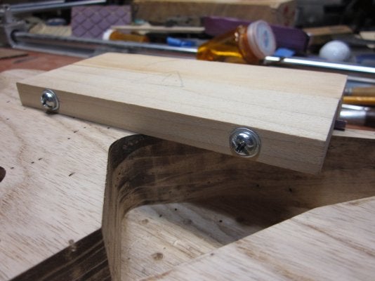

This simple jig below keeps your sanding block nice sitting nice and square to the body - sitting the body up on some scraps of 3/4" wood or whatever, allows you to easily sand the whole edge -
The sanding block slides back and forth on the work table easily, and the added piece of wood that sits at an angle helps stabilize and hold the sanding block square to the work surface
You can flip the sanding block over to efficiently use the entire sandpaper surface, and it's easy to change-out the sand-paper too - the sandpaper is held in place with a couple of little shims

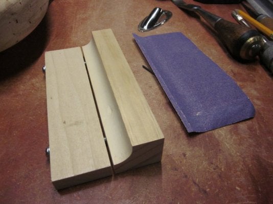

I made up this other little sanding gizmo below for sanding the edge round-overs - this one is made for the 1/2" radius round-over on the Strat body
I rout the cove into the jigs face with 1/2" radius core box bit (I think that's what it's called)
For a different sized edge round-over, you'd use a different size core box bit to correspond to the radius of the edge, of course
It's made from two pieces of wood which allow a piece of sandpaper to get pinched and held in place so all you are sanding is the round-over - not the face of the body
The two parts of the jig are held together by a couple of 8-32 machine screws that go into the embedded 8-32 T-nuts
The best part about the jig is it allows you to maintain that same nice consistent radius that you took the time to rout in the first place :)

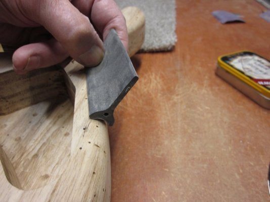

For the edge roud-overs, I also use one of these little rubber gizmos below - I've heard them called "sanding tadpoles" - they back up my sandpaper when I'm sanding a tight area - like the inner part of the bout horns
I have a set of four of them that I bought from Wood Craft - they are sized for 1/8", 1/4" 3/8" and 1/2" radius - they cheap and actually help a lot to keep the radius true

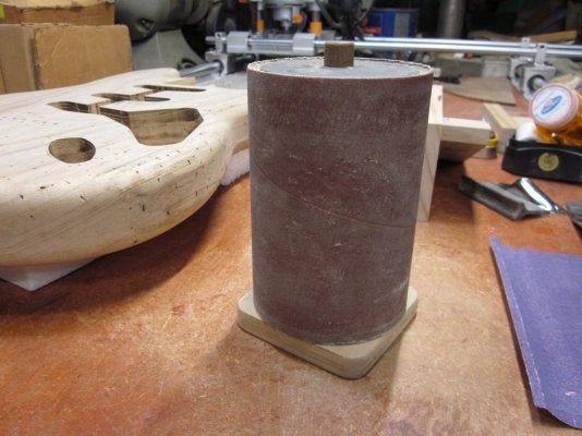

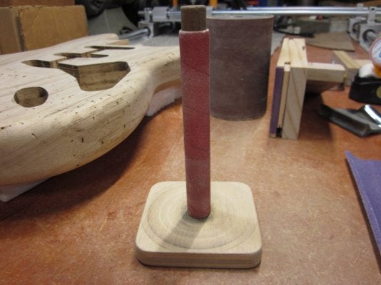

For sanding inside curves, I made up the real simple little jig below - it's nothing more than a scrap of plywood for the base, and a piece of 1/2" wooden dowel for the upright "shaft"
I used 1/2" dowel because the sanding drums for my ROSS have 1/2" diameter holes to match the 1/2" shaft on the machine
The plywood base holds the shaft perpendicular and also slides easily back and forth on the work table
This jig works best, and lets you sand the entire edge when you set the body up off the table on some scraps of 3/4" or whatever
You can either use a sanding sleeve on the drum, or just wrap a piece of the appropriate grit sandpaper around the drum, that's what I usually do
I have drums up to 3" in diameter - I've found I get the best results by using the biggest drum I can as long as it's a little bit smaller radius than the curve I'm sanding
