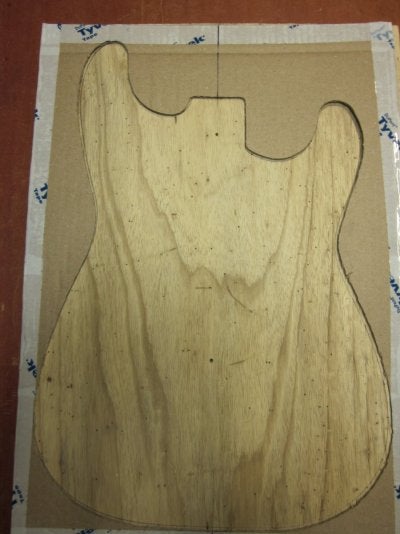

BB-MMXXIII will be a Swamp Ash Stratocaster-type guitar
I like using Swamp Ash for guitar bodies -
For some reason, probably because he could get a good deal on it ;), Leo Fender used it for both the early Teles and also the early Strats
For my purposes - I look for nice and light, one-piece blanks that have a nice grain pattern
Unfortunately - these sorts of blanks are getting pretty scarce (and very expensive!) - lot's of the Ash trees are getting wiped out by the Emerald Ash Borer and the infestation is being pushed by climate change, just like the massive kill-off of Spruce trees by borers in Alaska and west Canada
So even when I end up with less desirable Swamp Ash blank like the one I'm using for this build, I feel compelled to try to put it to good use
I don't know for sure, but I think the tree this blank came from was first killed-off by the Emerald borer by being attacked under the bark, and then after dying, it was further ravaged by borers that drilled all sorts tunnels throughout the rest of the wood before it was finally harvested for lumber
I ended up with this blank by mistake - I paid for a nice clean-looking, blond-colored blank, but was shipped this one instead - the vendor was real good about making it right, but I still had this ugly-duckling of a blank
After shuffling it around for a couple of years when I rotate my lumber stash, I finally realized that it has its own sort of beauty - bug holes, bug staining, spalting, and all :)
It'll be a hard-tailed version of a Strat
I've already collected most of the hardware for it and thought I was decided on the color - white-blond, but now I'm not so sure that white-blond is the right color - maybe just natural with a clear finish?
I'll need to do quite a bit of grain-filling, especially all the holes and tunnels left by the borers - maybe I should use a color of grain-filler that accents the bug holes instead of trying to conceal them?
