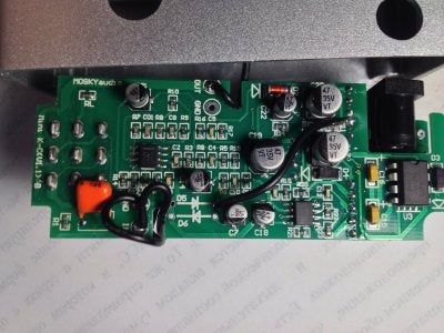

    Interesting...
    Notice your board has the holes to mount a normal size charge pump chip.
    I bet you could de-solder/remove the surface mount one and install a 8dip chip there.
    Be careful to get pin 1 orientation correct!

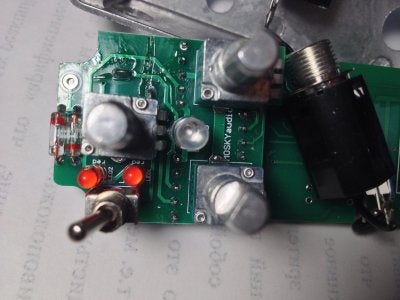

    silver horse inside on pics, leds for clipping are not very usable, different pump chip. No problems in one month.

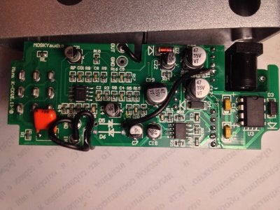

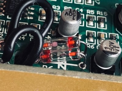

    As of May 2019 the Golden Horse has a full-sized charge pump, real TL072s, and nice diodes.
    So is there some truth in that the Moskey GH is a blatant copy of the Wampler Tunmus mini? Someone post a gunshot if you can.

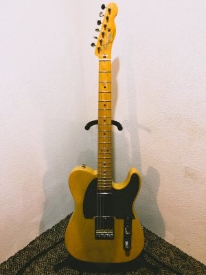

    Today is the Tele test with my 65 RI Twin.
    ** UPDATE: Works great with a stock Baja Tele and a 64RI. The pedal has a bright enough boost to add sparkle to the spank tone. Overdrives outstandingly with pedals, the tele, and the 65RI. Unlike a TS-9 this pedal does not dull the tone of the tele while boosting it. I basically set it like a fixed preamp for the guitar and the entire board played nice with the pedal.

    My PCB looks the same as yours.
