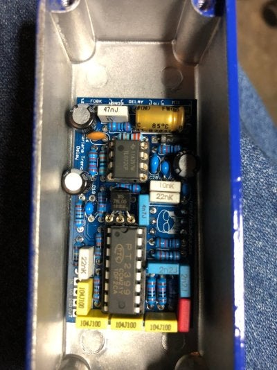

I mentioned in another thread that I ordered some boards from Delyk, starting with a through-hole PT2399 delay 1590A size build similar to a Deep Blue.
I've been building 1590A's as a bit of a challenge, the opposite of what I was doing last year with big complicated circuits like the Aion Lab L5 Preamp and their Blueshift, an awesome chorus. After those, I figured I'd build something smaller and simpler like 1590A's. Perfect for a Rangemaster, but the more complicated the circuit, the harder it is to fit in the box!
This delay board from Delyk should fit, but I've found clearance is really close when socketing chips. I ended up socketing the opamps on my mini-Klone, only because I was troubleshooting and out of extra TL072s. I figured out later it was my wiring goof on the pot sub board. No sub board for the pots in this case, but I am using Vero like Madbean describes in his building small pedals guide to connect the wiring. It will be a tight fit, hopefully not too tight.

Looks fun. Tight builds are always a challege!
Personally, I would skip sockets on tight builds like this. I would also solder voltage regulators (regardless of space) to have rock solid connection to feed PT2399. Not sure if I see the benefit of socketing voltage regulators..

The only reason I socketed this build is because of the reputation of PT2399's to not always be reliable out of the box and it's my last one. I have socketed voltage doublers in A boxes before too, in case I have a noisy 7660.
Another reason, the regulators I have are cheapos I got on eBay awhile back and I don't 100% trust them, to the point where I picked up some more from a respected vendor. I may remove that socket because if there is any place on this build where it won't fit, it's there.

It is alive! Delyk "Mariana Trench" Delay, a Deep Blue delay circuit clone:
Mariana delay on no enclosure.jpg Mariana delay off no enclosure.jpg Mariana delay chip side no enclosure.jpg
With the low profile sockets, it just barely fits in the enclosure. I had to bend the leads over dead bug style on the 78L05 so it would fit, the leads are below the height of the adjacent chips.
Still too cold for making decals so no final assembly until I can make one, boxing and unboxing 1590A's isn't a lot of fun especially when everything is as tight as it is on this pedal!

Boxed it, had a short. Unboxed, found the short and fixed it, back in the box to test with the bottom cover on and no problem. The knobs are too big though so I'll use some less snazzy ones. Mariana delay on no decal.jpg
