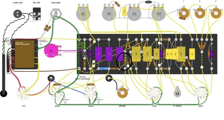

Just completed construction of the 5f11 Mojotone and everything looks solid, Only problem is when the trem is switched on I get a chirping sound with each cycle of the tremolo. I have done the bias mod which doesn't help, in fact it seems to slightly increase the chirp with increasing the bias pot's resistance. Putting the 56K resistor back in (I have installed a switch to select) decreases the chirp a little further, but still present.
Mojotone tech has indicated that this may be a bias problem, and I have measured bias current, which is 24.56 ma for V3 and 27.36 for V4.
Mojo tech has stopped corresponding-
I have borrowed a complete set of tubes, will start by replacing the 6V6's.
If anyone has any assistance to offer I would greatly appreciate.

Also, the Mojo bias-adjust circuit is hard to read on their layout. If I'm right, it should look like this. Does yours? IIRC, some Mojo builders have had to change one or the other of the resistors in this circuit to tune their bias range right.

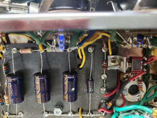

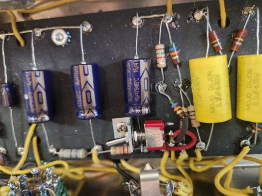

Third pic shows the 56K feedback resistor disconnected. 2nd pic shows bias mod with red wires. I put a temporary switch in to be able to return to original setup quickly, will remove and install a fixed resistor when finished tweeking. Sorry about 2,3,4 upside down from the assembly drawing with disconnected 56 K resistor circled.
Like I said, all noise (supersonic whine, clicks, chirps) was eliminated
Looking at the schematic, it appears to me that this feedback path will have very little effect on the V2a, and in fact, RobRob's feedback mod switch in the bottom position removes the feedback loop exactly like I did. I'm sending this amp with the resistor removed.
Noticing that Mojotone's power transformer makes B+ about 15% higher than Fender's original spec, I wonder if eliminating the feedback compensates. Would like to hear you Amp experts' remarks on this.
My son says it's perfect. At some later date I may experiment with the feedback, but probably not. We will evaluate speakers next, but he likes the Jensen C10Q. I will post the finished buttoned up item when I get my custom nameplate installed.

This sounds like the issue may be that the output transformer phase is wrong. If you are feeling intrepid, reconnect the feedback. Swap the connections of the OT at the output tubes, usually the brown and blue wires. Turn the amp on. It may Squeal (bad, so move the wires back). If it doesn't, run the amp with various settings to see if any obvious oscillation occur. If not, that is the correct wiring.
Edit: @Pete Farrington mentioned this in another thread - did the amp get louder when you disconnected the feedback? It should. If not, you probably have the OT wired backward.
Note there are other ways to accomplish this change.
Running the amp without feedback is not a problem. The famous 5E3 Deluxe has no feedback.

Swapped OT primary wires to reverse of the Mojo assembly drawing and voila! No noise. Put in a switch to turn off feedback. As expected, when feedback switched off there is a slight increase in volume. Son will be back soon with his guitars to evaluate speakers and we will investigate tone with/without feedback. Will update.
When working this switch with power on you must be careful to not touch other stuff in the amp. Ask me how I know.

NFB lift fixed Whine/squeal AND chirp/tick. Corrected OT primary phase enabled restored use of NFB.
I didn't think my ears were so bad - my son said "Really Dad, you can't hear that?" As soon as I knew about it I had grabbed the scope and sig gen, isolated the problem to the second preamp stage and was onto feedback almost right away. The boy was impressed with Pop's troubleshooting prowess.
