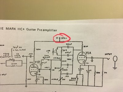

full credit to the author of the schematic and build thread that inspired me to consider the build and draw a DIYLC layout.
(schematic based on lead channel)
http://diy-fever.com/amps/mesa-mark-iic-preamp/

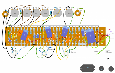

my first attempt at using DIYLC. (took me all day).
i would be so grateful if anyone could review my layout against the schematics provided above below and below.
- planning to use hammond 369BX PT.
- adjusted the filter cap values (from the schematic above)

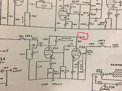

- a few other differences taking into account schematic below.
- not sure what to do with centre taps.. (or if i even need them)
- unsure if the ground for the bridge rectifier should go elsewhere..
would appreciate any feedback
thanks!

(other schematic)

The 50V tap is unused
The high voltage CT is unused
You need R, a 220k resistor to complete the RC filter with the C 0.022uF coupling cap. (One schematic shows a MV in this spot. The MV is the R of the RC filter. The other schematic does not show R. Depending on what this plugs into, this could be important.) See below:
The negative side of the Bridge Rectifier should be as close as practicable to the neg of the reservoir cap. You may be close enough.;)
I traced most of the layout, but not all. I will have a look at the rest later.

OK, I went through the layout.
I color coded the filter nodes.
The resistor I mentioned above will terminate with the purple node. To have separate nodes, there must be dropping resistors. I would suggest no less than 3.3k for excellent filtering.
There was a missing ground from the drive pot (noted in blue).
The *out* jack should be isolated from the chassis. (IDK if that is what you had intended yet.)
Gold star for keeping the nodes together.:)

Looks like an error in it, do not care all that much to check for others. the 3.3M resistor and cap. Might make more sense reading the article.

the 'original' schematic (supposedly from M/B) has x2 'master volume' controls, the 'lead master' (250K), and then 'master' (100K).
the 'diy schematic' by Bancika (diy-fever.com), that I've followed primarily for this build/design, includes the 'lead master' in the same location. the 'master' is absent in his design...... perhaps it isn't really needed?
he mentions that the final stage in his design is intended to be an ac coupled cathode follower:
"Voltage divider between 5th and 6th stage reduces signal level to just few volts to make it effect friendly.
Since I’m building the preamp only I don’t need the last stage to boost the signal back.
Instead, I converted the last stage to AC coupled cathode follower.
It’s supposed to be a transparent buffer that will provide nice low impedance output that should drive any effect and long cables if needed.
Since it doesn’t cut any bass, it will essentially have similar response like the original stage with deep pulled out".
OK, so that output coupling cap (22nF) needs a resistor to ground?
i would assume that would shunt signal to ground? (and reduce output volume?)
220K? any reason for that value? (just for my understanding, cheers)
what if I used a larger value (eg. 470K, 1M), for more output volume?
i wonder why he didn't include an R there? (quite puzzled about this one).

You are at a point where some education is wanted. Internet search for *RC filter calculator* (it will save you from doing the math). Every coupling cap is part of an RC filter. Every power filter cap is as well. If you know the frequencies of the guitar signal (and 50Hz VAC wall voltage), you will be able to manipulate the cutoff frequencies with the RC filter to reduce unwanted frequencies.
So, if the .022uF cap at the output of this preamp did not have a resistor. The input of the next thing plugged in would complete the RC filter. We don't know what that is. Let's imagine the next device has a coupling cap (high pass RC filter) as the first thing the signal encounters. The two caps would be in series. Caps in series reduce in value. The resulting RC filter would change the cutoff frequency from what was intended. You may have less bass than desired/designed. Completing the RC filter at the output of this preamp will keep that from happening.
Yes an RC filter shunts signal to ground. It gets rid of volume of selected frequencies. Not all frequencies.
The R of 220k with the C of .022F = a first order high pass cutoff frequency of 32Hz. The signal will be 3dB down at 32Hz and frequencies below 32Hz will reduce by 6dB per octave. Lows are being reduced but the highs pass to the next part of the circuit. Try different R and C values with the calculator. (Low E is 82Hz.) (low values of R will lose very high frequencies, so choice here is important depending on what you want. You may want vey high frequencies gone, or maybe not.)
He may have forgotten the R or most likely he assumed the next device would complete the RC filter with 1M to ground. Who knows? The choice of 220k. If the next device had a 1M resistor to ground as the first thing the signal *sees* the 220k in parallel with 1M = 180k. The RC filter 180k with .022uF = a cutoff frequency of 40Hz. Come to think of it, I would suggest a higher value for R and C because some amplifiers have around 40k as the first resistance to ground the signal may see... so how about 1M and .1uF? hah. As you can envision the next device plays a role here so choose this RC filter accordingly.

cliff jack would be better for the output? where should this be grounded? or is the sleeve/ground on this jack supposed to be completely unhooked/isolated?
I would ground it with the purple section of the layout I showed above.
ill be honest, im not sure how i earned the gold star, this concept of grounding 'nodes' you presented here isn't something ive seen before, i'm still a newbie
Read through the *Valve Wizard Grounding* Chapter 15 a hundred times or so and you will know why you received the gold star. hah.

Did you decide to muck around with output coupling or just leave it as designed? IMHO, I think you’re fine without a resistor.
A small 10R resistor on the ground lug of the output jack might be enough to kill any ground loop hum (through the other device) you encounter. Or a switch that lifts the ground going to the output jack completely.
yep, given LLCs advice, I decided to change it to 0.1uF/1M.
that's an interesting idea - so you're suggesting that inserting a 10R in between output jack ground lug and ground connection (back to the node) will prevent ground loop hum?
I guess if i have any issues, that would be fairly easy to 'retrofit' when it's finished.
thanks for the tip!
andrewRneumann
Mar 22, 2020
2,171
Cincinnati, OH, USA
that's an interesting idea - so you're suggesting that inserting a 10R in between speaker ground lug and ground connection (back to the node) will prevent ground loop hum?
That’s the idea. Just a little impedance in a near zero impedance circuit should be enough to break the loop.
I was reading an earlier post in this thread asking about MV. The 250KA pot before the AC coupled cathode follower is your MV. The cathode follower is designed to be a transparent stage that provides low output impedance. If you put a pot after the CF, you muck up the low output impedance and that was the whole point of the CF.
