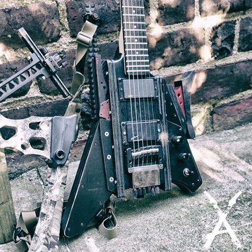

Here is the prototype of my new guitar.

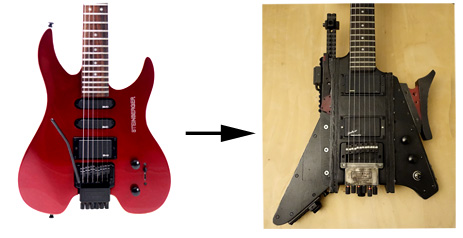

it WAS my Steinberger Spirit.
I did this crazy mod on my guitar to confirm my new construction idea would actually work.
Recently I released M16 Harrier model from my brand but that guitar is very hard to make so I wanted to try different design which should greatly reduce the building steps.
Oh, I'm talking about the construction of the body, not about the body shape.
I think it went very well so I am going to make a production model next.
(actually it's almost done on my work table)
The AR15 Carry handle, which I used for M16 Harrier, was too big for this little guitar so I put the classic M60 handle. I wonder if one of those video camera's carry handle would work on this...

Hmm.. I'm not sure if I like the cheap Overlord of Music bridge, even the original Steinberger bridge which is on the first prototype. Unlike Strat, it uses only one but very strong spring and that gives a lot of stress to other parts of the bridge. I googled and found many people experienced issues with this style of bridge.
Okay let's forget about the tremolo, I decided to mount the bridge using four screws to use it as a hardtail. I need to modify the bridge cavity.
