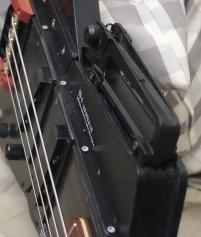

I am making a bass and a guitar model which design is inspired by guns or some kind of military thing. Here is the prototype bass. (this is my 4th proto)

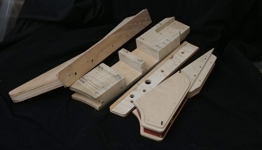

The body consists of MANY pieces and I am using screws to assemble the body, use of glue is minimum.
I am now finalizing the specifications and making production version of this bass and guitar at the same time. The Prototype was mostly plywood but I will use thick solid alder for the center core.

I think the neck dive was not a big issue with the proto but I may offer this picatinny rail option to improve the balance.
The bass leg rest did not work for the guitar version so I had to make slightly smaller parts.
Too many templates in my shop! The black one is an another design I'd like to try.

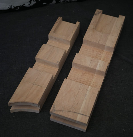

Discovered an issue with the prototype. Since the finish is very thin and the body has many sharp edges and corners, it "relics" very fast. I love aged finish guitars and I was enjoying the distressed look but that was until I see 'layers' of plywood starts to chip off.
Oh no, this is ugly! Baltic Birch plywood is hard and usable but it's edge couldn't get a lot of abuse. Unfortunately this part of the wing is where the bass touches to the floor. So, I've switched the material to ABS for the lower wing parts. Luckily, the ABS is black so I don't have to paint it.
