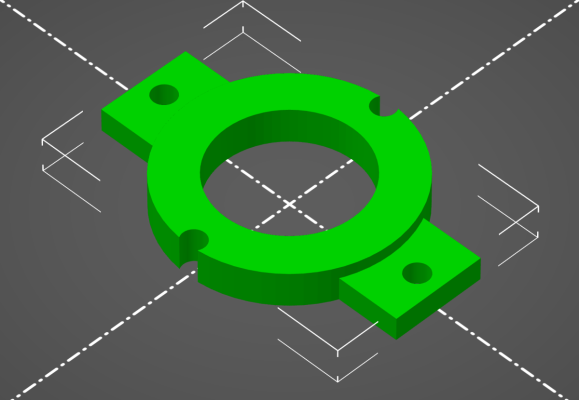

I 3d printed some parts for this build that might be useful for other people doing similar builds. Instead of using RobRob's layout where the first output tube is in the fourth preamp socket, I put a blank there, and designed two octal-to-noval adapters so the output tubes would be in line.

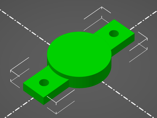

For the third octal socket, I made a blank with a curved opening for the PT primaries.
I also didn't use a cap can (more on that later) and instead designed a blank with another curved opening in the middle for the PT secondary and choke wires.

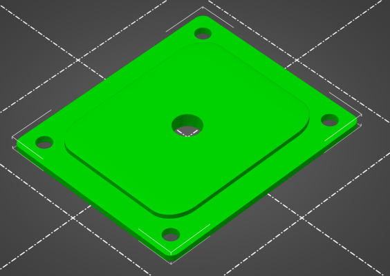

Finally, I designed a blank for the PT opening with a hole for the Antek transformer mount.

Here's some pics of the 3d printed parts in the amp.
The octal-to-noval adapters. I shock mounted the sockets with some silicon o-rings I use for my espresso machine.

The Antek mount from underneath.
The cap can blank with the "grommet" for the PT secondaries/choke wires:
