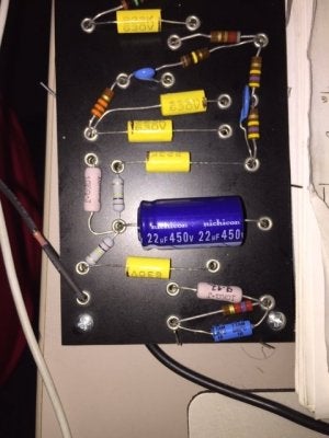

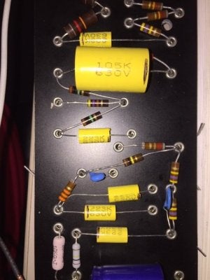

I decided to attempt to put the reverb back in Rob's Blackvibe, but then I found the Master Volume Micro.
I think it is a good place to start and an interesting amp. So I'm starting a tread of my build as comic relief. :D
I have my board from Hoffman (thanks Doug, great board) and most of the pieces parts.
Uploaded some photos of the components on the board, if I have already made a mistake hopefully one of the nice folks on the forum will point them out. Link to Rob's page https://robrobinette.com/RR2104_Master_Volume_Micro.htm

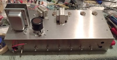

Chassis is 15" x 7" x 3", started drilling it but now waiting on the transformers before I drill any more holes. PT is 275-0-275 @ 100mA with 3.15-0-3.15 @ 3A with 120V or 125V primary. Being custom wound with no 5V or Bias tap. OT is a 2W 22,500:8Ω

Just want to double-check with you that you have the underboard B+3 wire in place?
When you play this amp for your friends you've gotta show them the four 12A*7 tubes before you fire it up. The tone is mind bending.
Rob you made me go look to be sure. Yep, it's there.;)

@robrob , I noticed that you made a revision to the heater center tap elevation?
I have my board obviously as the original layout, is it worth adding a couple of eyelets to include that change?

The 65v heater elevation was added to make life easier on the cathode follower and add safety bleeder resistors. If you have the tools to add eyelets then I recommend you do it but I wouldn't bother if you don't have the tools.

Had some nasty weather last week and had tree damage to clean up, have not had time to do much to my amp project.:mad:
However I did have some time today.
Added a couple of turrets and made the changes to the board to facilitate the 65v heater elevation.
After some problems, got the face plate done and some other controls and components installed and some wiring done.

The chassis is 15" wide 3" tall 7" deep. Cab will be a head cab 16.5" x 7.5" x 9"

Dang I used the same Hammond chassis for my recent micro build as well! Plenty roomy, could be smaller but I'm happy with the choice.
I put my FIRST build on hold because I used a chassis TOO small for the deluxe micro and ran into issues... like I can't do this, it just does not fit.
I'm going to salvage the parts and order a larger chassis and finish it however Rob posted this amp and I just had to build it first.
So i got the widest chassis from Hammond so I did not make the same mistake. I agree it could be smaller but so far I am having much more fun assembling it with plenty of room to work.
