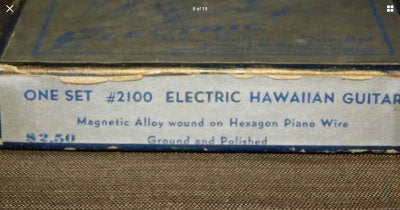

I came across this page, purporting to be from a 1950 Fender catalog, which shows Mapes branded strings being sold by Fender.
I think it may be a reasonable assumption that these are the OEM Esquire, Broadcaster, Nocaster strings.
Further searches indicate that these strings used hex core wire, were likely a Monel alloy, and were round wound, ground and polished. (Similar to modern D’Addario half rounds?) This is from a Mapes Hawaiian set, but all indications are that the composition is the same for the Spanish set.
