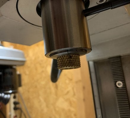

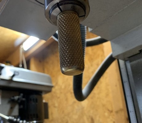

Next, we use a 3/4 collet to hold it in the spindle and turn the mill into a lathe so we can knurl it.
With all the oil and fine brass particles, it can make quite a mess so I clean it up with mineral spirits and shop towels before the next step, otherwise it looks like Goldfinger paid a visit.

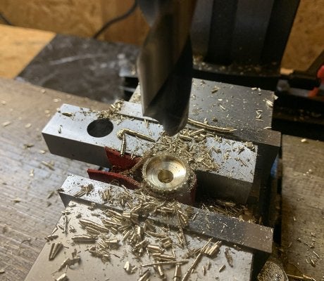

I drill the 1/4 holes for the pot shafts with an undersized drill bit mounted in a mill collet instead of the drill chuck. This way, everything fits all nice and tight when it's finished and not horribly loose and crooked. If you're more competent than me, your results may differ.
Then I break out a 5/8 drill bit, mount it in a collet as well for stability, and make that giant counter sink hole to fit the pot washer and give it that nice conical step like the original 50's knobs.

I had never seen a "knurler" contraption before -- I thought they were sliced in with some spindly thing
how does the knurler work? is it like a press?

Yes, this particular one is a pinch knurler. The two arms pinch the material as it spins and press the grooves into it. There are other types but, I went with this kind because it seemed more stable for my setup. Before the knurling, the brass is .750 and after knurling, it gets pressed out to about .760.
