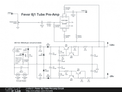

As per the title really. I was bored and browsing Ebay one evening when I came across a preamp kit based around a pair of 6j1 valves.
Hmm. Remove the on/off/pot and short out the switch part. Feed the left channel input through a 50K pot ( 50K is what's used on the board ) to set the gain, then take the left channel output and feed it through another pot ( value to be determined by experiment/what I have to hand ) in to the right channel input to set the output gain/level/volume, call it what you will. Basically building another low voltage valve overdrive. These boards take a 12V AC voltage and through on board magic bump it up to 56V ( +/- 28V ) so hopefully it'll be a little less sterile than a 9V or 12V starved plate pedal, while still not being the full 120V the valves would like.
I've got a Behringer VT911 that is to be sacrificed for the cause and it is large enough to house the board and a 12V transformer. It'll also provide the switch. I have a suitable mains switch and inline fuse.
Any obvious flaws in this plan?

Part one completed. Build the thing. I didn't bother fitting the blue LEDs under the valve bases as I think they look gash. It went together easily. The component values are printed on the PCB.
The PCB is a thick, rigid, double sided with through plating affair with easy to read silk screening. The components are OK. I struggled t read half the resistor values, but Mr.Multimeter stepped in to save my blushes.
Next, jury rig a transformer and power up.
No popped components, no smoke. Yay!
Next, try it between my CD player and my amp. First, set a reasonable volume level and listen to a song. Next, insert this into the chain and bring the level back up to where it was before. It seems to get 'unity' about halfway through the travel of the pot. Sound wise?, not much difference really. Bring the level up a little higher and the bass is less focussed and cymbals lose a little shimmer. Does it make a CD sound like a 60's radiogram?, nope. Does it sound bad?, nope. Does it improve my CD playing experience?, nope.
Next, connect the 'phone and play a FLAC file. See above.
Next, MP3. Wow!. The zizz and tizz in the upper end that I dislike about MP3 is masked rather nicely. This thing actually does what it's supposed to do!. Colour me surprised. The harsh edge to MP3 is replaced by a woolliness that reduces fatigue. Introduce distortion to reduce fatigue. An interesting idea.
Not what I wanted it for though.
Next, jury rig a couple of cables. Guitar --> right input. Right output --> left input. Left output --> amp. For now, it has the dual gang pot still fitted, so not the best route to sonic nirvana, but it's only early days. When I get round to replace the pot with separate pots, it'll have rather better control. First impressions?, it's a smooth, overdrivey kind of sound. Even wound up full, it doesn't get harsh and bitey. Quite smooth and lush with a pleasant bloom on branged chords. It needs winding up quite high to get the signal going, again, when I get round to using separate pots for gain and output level, that'll change ( I hope! )

Some pictures.
Shows the input at the top, the link between right out and left in ( bare wire linking the phono connector pads, close to the transistors ) and the output, close to the transformer input.
Underside of the board. Nothing much to see here, except top right there is a wire link. Two pads near D1 need linking. This is -NOT- in the instructions, but if you buzz it out, it connects the power in to the switch. Maybe not all boards need it, mine did...
Not exactly clear here. The pot I've marked up as 'Gain' connects to the frontmost set of pads in place of the supplied dual gang. The pot labelled 'Vol' goes to the rearmost set of three pads. I used B50K because that's what I had kicking about. You may want to try audio taper and a higher value for the 'Vol' pot.
Just another general top view. It shows where I shorted the power switch behind the control pots. Valves removed for clarity, LEDs not fitted!.
The spurious yellow wire is part of another 12V from the transformer, possibly to be used with an OEP20W Class D mini amp in the future. I'm still looking for a suitable enclosure. As I have it now, it isn't exactly safe.
Hope that helps.

By using two pots, it allows the first valve output to be high, which in turn drives the second valve into overdrive/clipping, then you can turn the whole thing down to a suitable level for the input stage of your amp. It also allows you to play about with 'starving' the second valve of signal and winding the volume right up to get the desired output. Both scenarios sound different, both have their uses. One way sounds more 'gainy', the other, more compressed.
It's no different really to the valve pedals that use a 12AX7 and cascade one triode into the other, we're just using two separate triodes.
I've found it doesn't get as gainy sounding as a 12AX7 pedal, but gives a nice, rich bloom and a pleasant growl without fizziness. It can also drive the first valve in the amp into overdrive.
Now I just need an enclosure.
I've played about with an OEP20W micro amp board from Ebay with it. I used an A250K pot between the pre-amp and it and ended up with an amp capable of somewhere around 10 Watts that actually sounds OK.

From the left, the cable labelled 'IN' is connected to what would be the left phono in. The centre ( black in the picture ) connects the tip of the jack socket to the left phono in with the braid connected to the ring of the jack socket and the common ground rail under where the phono connector block would fit.
The wire link between them effectively connects left out to right in. Working from left to right, we have left in, right in, left out, right out, power. You're effectively joining the middle two phono connectors.
Underside of the board showing the common ground rail at the lower edge. Power is coming in at the left hand side. The second row up is signal in.
You could use a pair of phono to 6.35mm adaptors and a phono lead. Adaptor in each of the outermost terminals and a phono lead to jumper the innermost pair.
Something like these.
http://www.ebay.co.uk/itm/RCA-Phono...e=STRK:MEBIDX:IT&_trksid=p2060353.m2749.l2649
Another view. At the top, you'll see the wire link. This is effectively linking the centre pair of phono terminals ( if you've still got them fitted )

might be a better idea to place 1st pot between the 2 triodes (where you connected the 2 stages) and the 2nd pot after the 2nd triode ?
VintageSG
Mar 31, 2016
7,766
Yorkshire
It would probably be a very good thing to do. You'll probably need to short out the pads where the pots originally connected.
