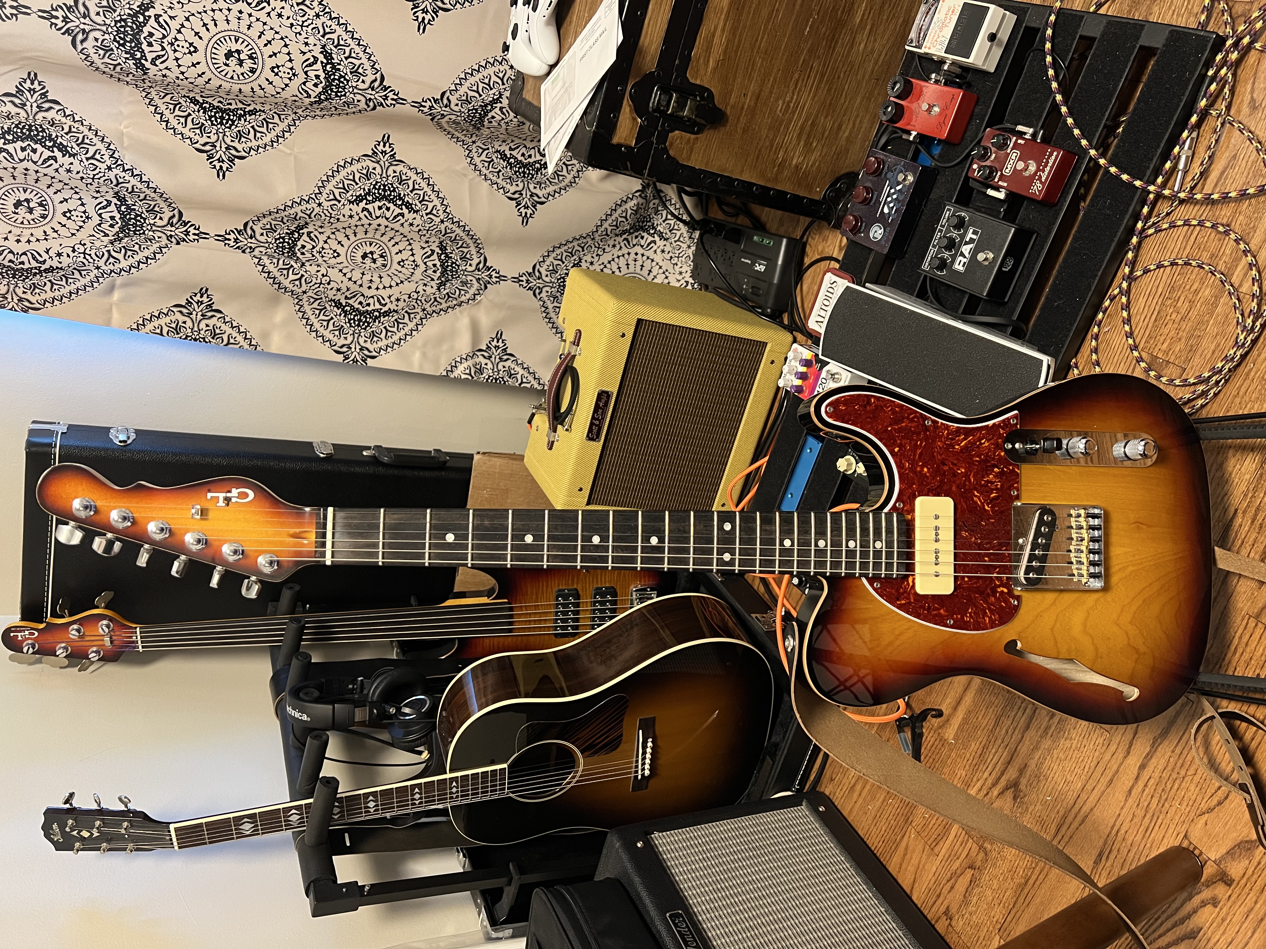

stickwithit
Aug 27, 2022
10
Estados Unidos
I’ve got these on an SC2 I bought used. Best locking tuners I’ve tried. The Schallers G&L sells are good but I love how these vary the tuning ratio for each string.
Sent from my iPhone using Tapatalk
To get those Graph Tech Ratio locking tuners working on your single-pin G&L ASAT, did you have to cut new pin holes?
