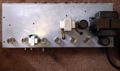

The $45 Arkansas copy of the Mojotone copy of the Princeton Reverb chassis is my go-to! Four so far with a 5th in the planning stages. Looking forward to the rest of this thread.
Fender-ish reverb amp with push-pull 12AB5 power amp. Multi-section caps in the 1.5" and in the V7 openings.
Same as above. Note the 1-3/8" to 7/8" adapters at V5 and V6.

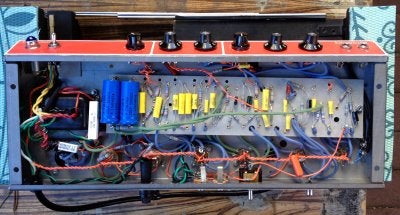

A complete 6K6GT-driven Fender reverb unit piped into a simple amp based on the Matchless Spitfire, but with lower gain phase inverter (6SL7) and push-pull power dual triodes (6SN7GTB).
Bottom view of above. Again using my favorite filter capacitor mounting scheme.

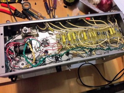

A push-pull 6V6GTA amp based on the Princeton, but substituting (5-triode) harmonic tremolo for the standard effects.

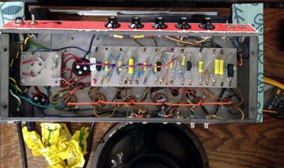

Marshall plexi-inspired preamp with Vavlewizard's transformerless reverb driver, some details cribbed from Matchless, and another push-pull 6V6GTA power amp.
