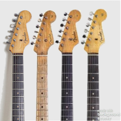

    I have a question regarding tuners.
    I’m currently building a replica of John Frusciante’s Red Fiesta strat but I’m not sure what tuners to go with.
    Ive saw online that he uses Kluson tuners but looking at an image of his guitars (see image attached), it looks like 2 different sets are used across his guitars as the buttons seem to be different sizes (see front two strats have larger buttons that the back 2).
    I purchased some Klusons deluxe tuners but haven’t installed them yet incase they’re the wrong ones. I have another guitar waiting for replacements so they won’t go to waste if they’re wrong.
    Can anyone help out with this? Could they be Fender Pure vintage tuners, Gotoh?

    I did think it may be an optical illusion but when you put them side by side, they do look slightly bigger.
    check out the image below. Ones on the far left and far right look bigger than the 2 in the middle.
    From left to right (61, 55, 62, 61) all are said to have original hardware but the two from 61 are the ones that seem to have the bigger buttons.

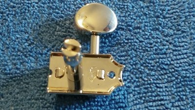

    These are the current vintage Kluson manufactured for WD Music...

    Obviously, you are. There's NO difference in size if you compare vintage and contemporary Kluson tuners.

    There are "no line", "single line" and "double line" tuners.
    If you look at the box mine came in, there's a column for the manufacturer to check how many lines the tuner has.
    So that's different.. the box.
    That, and the number of text lines stamped on the back of the tuner. Other than that there is absolutely no difference in size or shape of any part of the tuner.
    Go to the WD Music website and you can see that is the only difference, regardless the number of lines, or the color.

    If you've read my post: NO, since there's no "bigger" tuner buttons.
