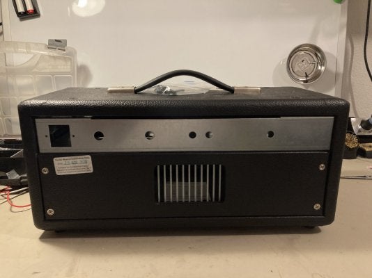

Seems that 6G2 are a popular build these days, and with a few Super Champ X2s lying around, I have decided to give a go with a build that will fit and use the existing iron. Took me a while to draw the whole thing in CAD and for the machine shop to build it, but the chassis is finally here...
On to the quick chassis test fit!

Btw, I've often wondered that- if I can just go to some machine shop and have them make a chassis. I just assumed it would be huge $$.
Well, I guess you just need to find a machine shop that does small volumes. I have found one not far from me and the labor is anyway north of 95% of the cost. I guess anything between 30 and 60 EUR for a single piece would be reasonable.
Cool. Are the holes threaded for mounting screws?
Yes. My previous builds all included cagenut mounts, and this is the first threaded mount. The Super Champ has the same mount on the chassis that‘s thinner than mine so I am guessing I will be fine.
