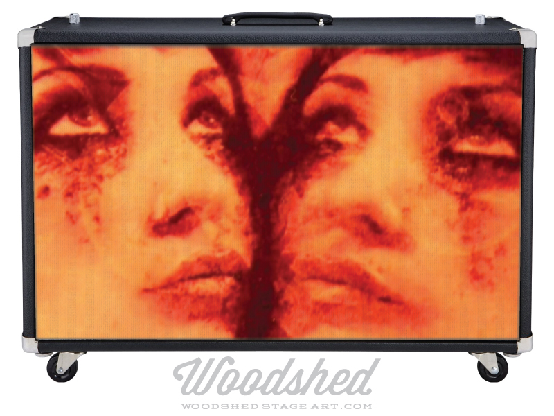

I've done many grill cloths in my day. If its a cloth material, like on these fenders their is much easier way to do this. Lay your cloth down, then place your baffle without speaker on it and line it up, nice and square. Make sure your baffle edges are clean from old cloth and staples. Buy a can of 3M adhesive. shake real well and spray a little a empty pill bottle. Use a small one inch paint brush and apply just the top baffle with the glue. Wait five minutes for glue to get tacky. Fold over cloth evenly and lightly smooth. I wait at least an hour then do the bottom. Gently lift up the baffle and use any small spritzer bottle and dampen the cloth with water.You really don't have to stretch the bottom cloth as much as you think to get a nice even tight look. Repeat the process for sides one at a time. Once dry, flip over and trim, I use a ruler and sharp knife to trim. Trim at least a quarter of an inch into the glue down cloth. Makes nice edges without fraying or coming apart. And that's it. This link below will show of of the cloths I did. good luck.
https://www.filepicker.io/api/file/Uy0Ni4UTyajlor8jl283+file.jpg

I've never used glue of any type on a grillcloth board, I don't see how you could stretch the cloth to get the lines straight, and it would be very easy for the glue to bleed through the grillcloth as open as it is.
I tried the link but all I got was a picture of what appears to be a painted grillcloth on a cabinet.

First off.. I'm only referring to cloth, not basket weave for a glue down. Also, the post was referring to a 1x12 fender. I would never glue down a cloth on mdf period. or plywood that's old, and lost its integrity over time. Sorry, I sent the wrong link. Here's a couple 1x12's with a glue down.
