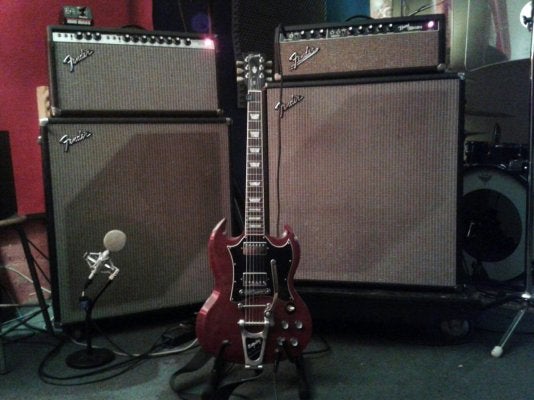

My main amp is a ´66 Deluxe (no-reverb) - but I recently had a bf Bandmaster AND a Bandmaster Reverb 👍
I liked both amps, but I re-sold them because I couldn't really use them...
Like the other guys said - the sounds are (somewhat) comparable, but the Bandmasters are MUCH louder/tighter, and they´re also a lot heavier.
The heads alone weigh (almost) as much as the DR combo 🙃
Wish I had kept the bf Bandmaster because it´s so cool, and it has a sound of its own - but I still wouldn't´t know what to use it for ;)
The guy who picked up the Bandmaster Reverb + cab played it at our rehearsal-space for a while. It sounded great, and he was REALLY happy - but I knew right away that I won´t ever play THIS loud again ;)
Bandmasters.jpg ;)
cheers - 68.
