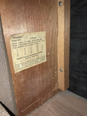

I see the L.C. For March 1962, but what is the handwritten A for, and the production 7?
The "A" I think identifies the person who wired it up . There may also be a small piece of yellow masking tape inside the chassis with someones first name written on it in pencil. I've seen "Lupe", "Billie" and "Lily" in some early Fenders.

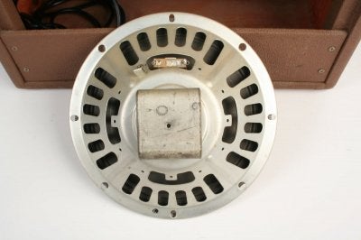

Some people say that the A is for Alinco speaker some have Oxford JB 14 alincos what speaker did it come with?388ABD75-AD45-414B-B6A1-5F1D92814ECC.jpeg

My friend thinks this may be his old 6G2 that he originally sold a few years ago. If that’s true then it came with a gold oxford ceramic speaker
