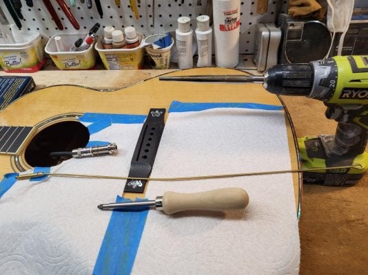

This is the right tool for the job. <Edit> This is a stock photo and not the tool I actually use. I use the Irwin in post #7.

Actually this works nicely for opening up an end pin hole if you get a step bit that has 1/2" as the largest step. I've used one for years. Makes a very smooth hole. Irwin Unibit #1.

End pin jack needs a deep as in long hole through the block that is not tapered.
Step bits are suited for thin material, not really for the end block in an acoustic.
Might be best to pay a tech or luthier if you do not have the right tools for the job?
Even with a quality reamer, you do not want the end of the hole you plug into to be larger than the diameter of the jack, which it will be if you use a reamer or stepped bit that is smaller at the other end.

"This is the right tool for the job."
Actually this is the right tool for the job if you get a step bit that has 1/2" as the largest step. I've used one for years. Makes a very smooth hole. Irwin Unibit #1.
No no no! You can't drill deep holes of a consistent diameter with that. Those are only good for sheet metal and other thin materials that are less thick than each step of the bit.
Drilling an end block on an acoustic with that bit would be a big disaster.

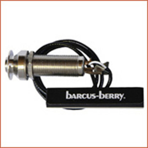

Man, as I recall, I just used a drill bit of the size stated in the installation directions for the Barcus-Berry piezo I put in my Guild D-35 back in 1983, about a month after I got the guitar (brand new off the showroom floor). I put painter's tape over it, and drilled out the hole. No biggie. A little spooky but, no biggie.
The pickup looked like this:
I still use that guitar (with that pickup), today, some 40+ years later.
I don't understand what the big deal is. Just tape it up and drill out the hole!
