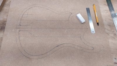

    Lets start with the design. This time around I would like to build a double cut strat type guitar to complement my previous build.
    The bridge, knobs and complete neck are the same as on my previous guitar, I just made a new body shape. I tried to mimic the "double bend" in the contour of the horns.

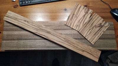

    This picture has the actual wood added. Wengé for the guitar top, marblewood for the fretboard and headstock veneer. Not in this picture are the mahogany for the body and the black limba for the neck.

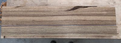

    I think I'll keep the text on this thread a bit shorter. I struggle a bit to type something original every time.

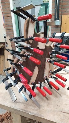

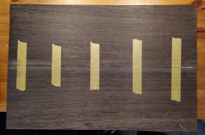

    Off camera I resawed, planed, edge jointed and glued the wenge top piece.
    (with my non-final neckjoint shape)
    And received some wood!
    Ripped the greenish part off the neck blank, this will make another neck in the future.

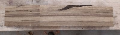

    Sawed and planed the scarf joint.
    I sawed it in a non standard way to make the grain match up. A quick sketch:
    And ripped a piece off the neck blank, one side is still straight for routing the trussrod channel. The grain match looks a bit off here, but on the bottom it's almost perfect. We'll see what happens when I start carving the neck.
