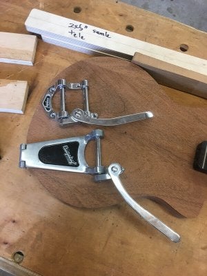

Sand it with grey 3M pads for a matte look. That’s enough for alu. You‘ll get a „raw deal“ look that‘s very nice. Check the Bigsby:

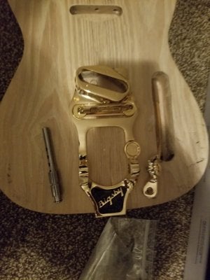

I got this in the mail today so now im running to Hobby lobby to get some plaster or maybe Lowes for some cement. Either way this is happening.
If, and it's a big if that I can get this done, I'm happy to barter this away or sell it for about a hundo, mostly for time and effort. The metal is cheap enough.
Still gonna slightly change the design slightly to avoid the hassles with patent popo.
