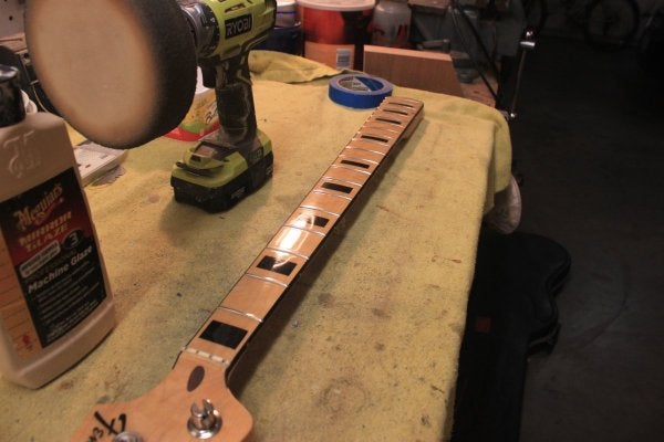

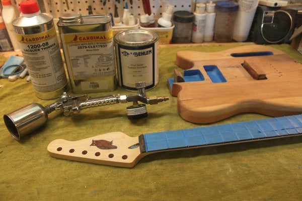

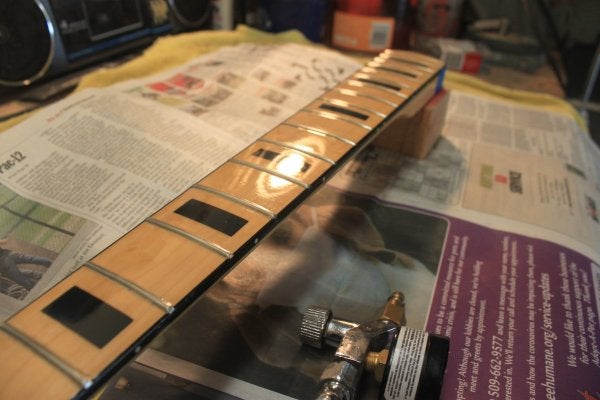

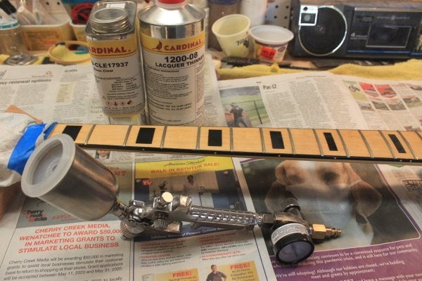

The problem with a one piece maple neck is that the fretboard is finished right along with the neck itself. That pretty much means the finish needs to be sprayed, which pretty much means either nitrocellulose lacquer or one of the catalyzed poly finishes. After the finish has been applied the very tops of the frets are scraped off (the frets were leveled and crowned before the finish was applied).
Attached are a few pictures of refretting a bass neck, the steps are the same for starting from scratch. I will add that I no longer finish or refret one piece maple necks - its just too much of a hassle and I'm happy to let someone else do it.
I actually did a thread back when I refretted that old bass, you would be starting at post #2.

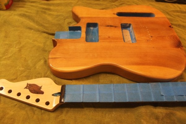

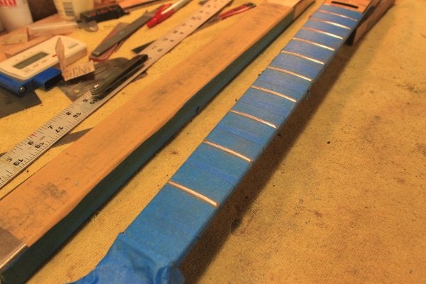

I only build two piece necks (separate neck and fretboard). Most of my necks are mahogany but I have done a couple of maple necks. My fretboards are either rosewood or ebony.
I only finish in nitro, mask the fretboard and spray the neck and head. A little bit of lacquer will sneak under the masking tape, it scrapes off easily. If I'm doing a mahogany neck it will be pore filled, maple will not. Lacquer gets buffed as usual. Attached are a few pictures
