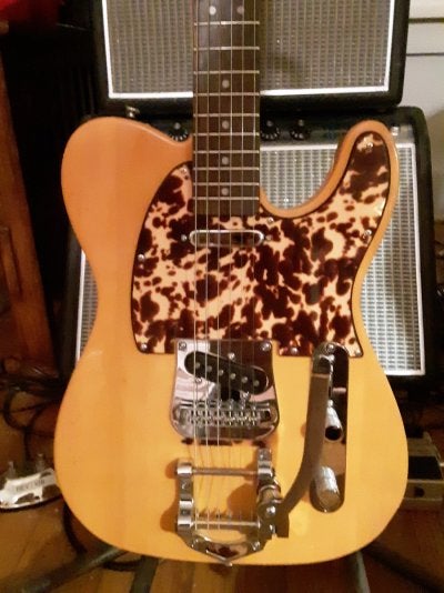

Trying to produce a Cooder Caster look, I purchased self-adhesive tortoise film. IIRC, it was sold in 18" sheets. I ended up not doing the headstock because I didn't want to cover the Squier decal. The film works better if you use a white backing, otherwise it can be quite dark.
Otherwise, if you are using something thicker, Duco or E6000. Best to squeegee the glue to uniform thickness before placing the plastic, then use a roller to ensmoothen it after mating the surfaces. It is very easy to use too much glue and create an uneven surface.
I suppose a quality automotive spray adhesive would work as well - probably a 3M product.
