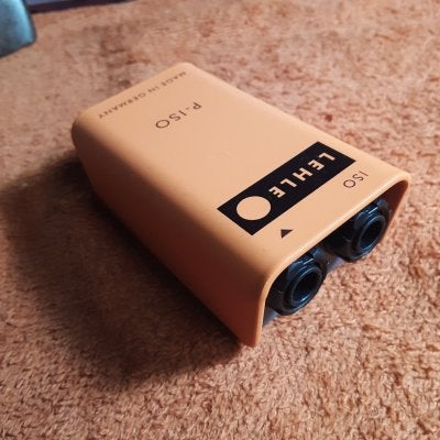

Using a chassis grounded power cord requires isolating the input & output jack's from the chassis, or you'll get ground loop hum. (The reissue jacks are isolated). There are some modifications on the internet using diodes for ground wiring in a reverb tank.
On my '66 Traynor tr-1 reverb unit (metal jacks mounted to chassis) I went the simple route, green ground wire to chassis, then use a Lehle P-ISO isolation transformer box from the reverb output to the amplifier input.
The P-ISO also comes in handy when you're jumpering the inputs on 2 different amplifiers simultaneously.
