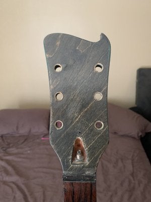

    I have a 67 guild Starfire III body that I got very cheap- the reason being the neck is a mess. Someone replaced the headstock and did a sloppy job. Worse yet however, is when they did so it seems they couldn’t manage the binding route- so they narrowed the entire neck the width of the binding on each side. The width at the nut is stupid narrow as a result.
    salvaging the neck will not be easy- if not impossible. Not sure if the heel is reusable or not, there is not a lot of info online about making new set necks... Which surprises me, as there are plenty of gibsons worth making a new neck for at any cost.
    Is this something a luthier might take on? Obviously it would be expensive, but how expensive? Considering the guitar is a nice vintage instrument, and I have almost nothing into it, I’m not sure I could go wrong either way unless the cost of a new neck exceeds the price of another vintage unit.
    By sheer coincidence, my dad has a 65 or 66 starfire III, so I have all of the dimensions of an authentic vintage neck and a headstock to trace.

    the easy way to make it a player is laminate in the wood needed to make it work right and paint it (the neck)(maybe the whole guitar)

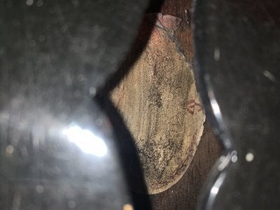

    This guitar is fully hollow, so it does not have the long tenon of the 335. That’s all I really know about it sadly... I took pictures of the guitar, the mods, and inside the body of what I assume is the base of the “dovetail”

    OK, if its really a dovetail (it has to be about the shortest I've ever seen) then the project gets somewhat easier. We steam dovetail joints apart all the time to reset them - lets assume that we can get this apart too. Then its just a matter of making a new neck of the proper length and geometry, routing the dovetail tenon and setting it. I'm used to seeing dovetails on guitars with 3 or more inch neck blocks, the reason you don't see them on thin lines is there just isn't enough vertical sides to the tenon to really get a tight fit. It is also interesting that yours seems to join at the 14th fret - I expect that more on a hollow body than a semi hollow.
    Here is a typical dovetail on a hollow body, yours is much shorter
    So, its still not trivial but it would make a good project. As I stated before, I would do it for the challenge, I would not do it for someone who was sure that it was going to come out perfect.

    In looking at the pictures, I can't see the dovetail at all. How can you tell it's a short one?
    The neck block picture is taken straight on. There doesn't seem to be a way to guage its depth from the photo.

    that buttugly headstock design can be repaired with a glued on piece. it's going to be all black again so you are free to laminate back some wood to re-shape the neck. you can probably get a reproduction decal for the logo. doing the binding you prolly want to farm out unless you get a new wider fretboard and go natural. guessing it needs frets.
    most of the structural repair you can do with limited tooling if you are even half hand with wood. and, you're really not out anything if you mess it up

    What I am talking about is the vertical height of the neck block from top to back. You need a certain amount of height to make the dovetail work - I simply have never seen it done on a thin bodied guitar like this one.
    The fact that is it a dovetail makes it a little easier to get apart, the lack of height means setting the new one might be problematic.

    I see. I managed to get pictures of one with the neck removed on another forum, so this is a what the dovetail in question looks like:
