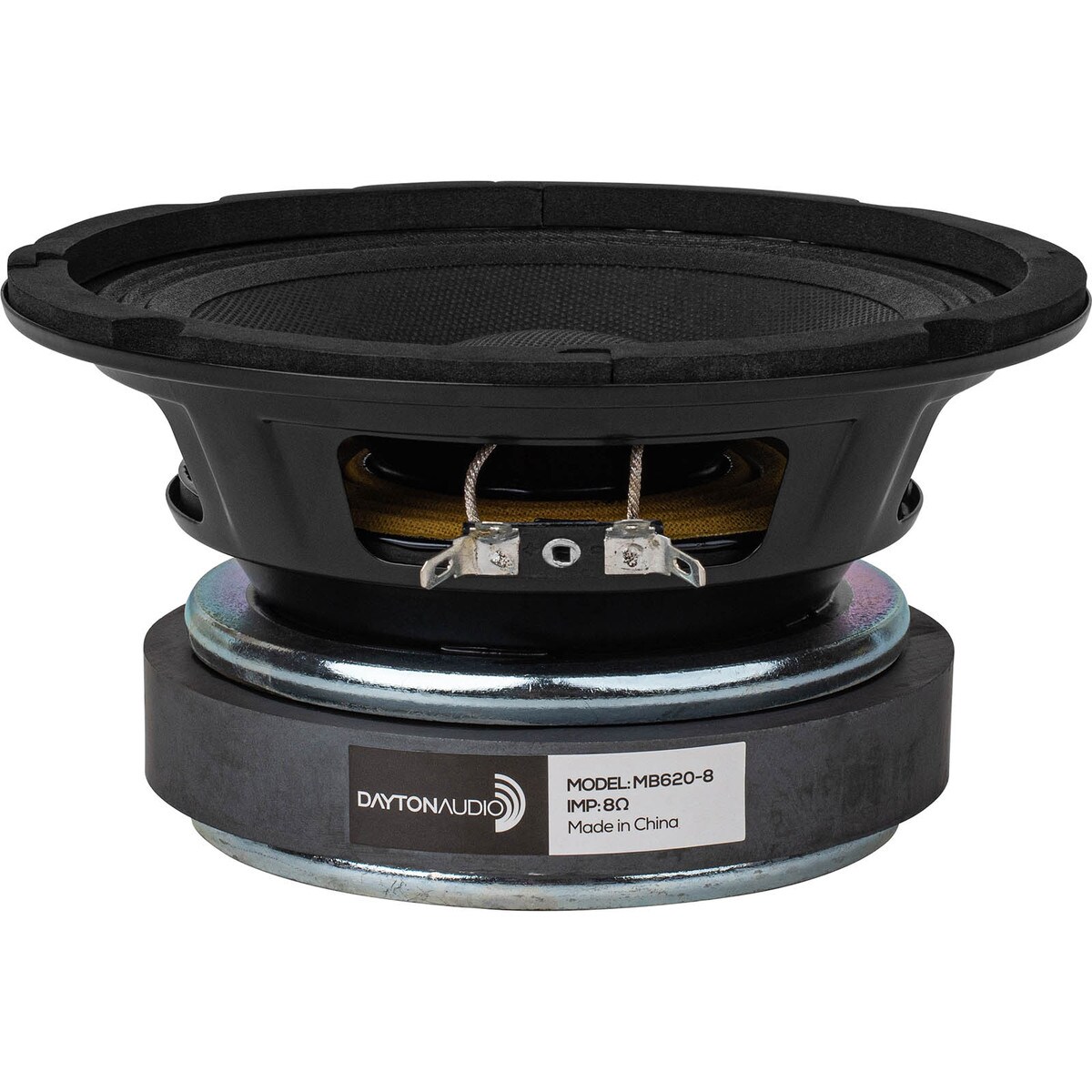

ok, I appreciate it. I've got a ported twin 8" cab that I'd like to increase volume with more efficient speakers, I'm not hard over on a FRFR. I know from experience that two speakers with the same "sensitivity 92 dB" can be of very noticeable different actual loudnesses. I'd like to re-speaker with a JBL, but don't want to spend the big bucks on this project, so the 8MGs look attractive at $65 each.

Right, sounds good. You might also give a look at the Selenium 8MB4P which is still available out there online for approx same cost.
Edit: one big difference with the 8MB4P is it's 97db rating.. in case that matters.
Also, it has an absolute peak at about 1.5kHz.. if you don't like that powerful a response in the mid-mids, you may not like that one

Also, I would recommend a scan of Parts Express especially the Dayton Audio 8" PA/woofer/midrange type speakers .
They have a few that are pretty similar in design, specs, construction, etc. and most are priced reasonably at about $35-$50.
Edit:
Here is one that might be worth a look:
Check out the PRV 8" options too. Some look like great guitar speakers. Reasonably priced too.
