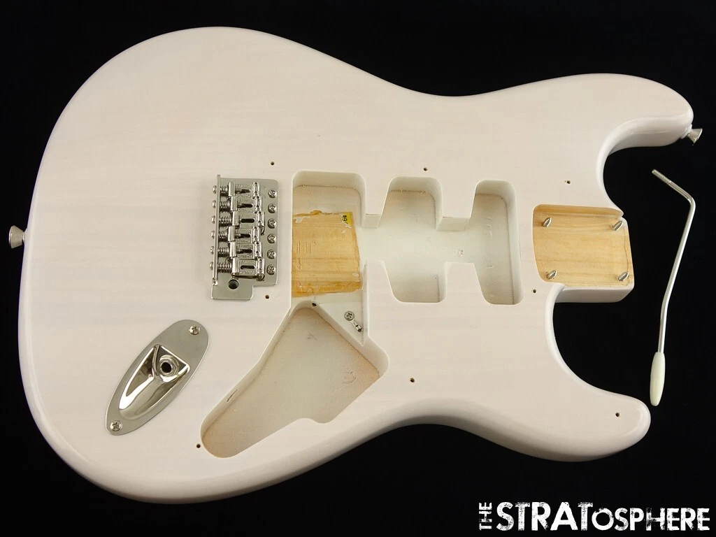

Just the other day, I got the urge to have the Mary Kay color like the original. I bought a new take-off Squire Classic Vibe '50's White Blonde (Mary Kay color) body from Stratosphere. I will have to plug the import bridge holes and redrill for vintage bridge spacing but that's easy to do and hidden under the bridge plate. The sunburst body will hang around for another project.

Tinted shellac will certainly go over lacquer, but I don't know that padding it on is the way to go with such an irregular surface, at least at first. It might be a good way to finish up. Either way, it will take a lot longer than spraying lacquer and may slowly wear through to reveal the more hardy lacquerfinish underneath -- why may actually look realy cool. Deliberately wiping it from the high areas and allowing it to remain in the recessed grain (like a tinted grain filler) could also look cool.

I thought I might have to use shellac as a barrier layer if I was going to spray a solvent based acryllic over the existing nitro. That's why I was asking about it before. I have since learned that it's not needed it if the plan is to simply de-grease the body, scuff it, clean and de-grease and then spray an opaque acryllic over it. I think I will go this route for now. Had this body not had the stain on it I think I would go with a burst of some kind. Maybe on the next re-finish.

Should be good... sounds as though you know already that nitro lacquer and acrylic are usually compatible as long as they're not catalyzed. Clears may yellow at different rates and thick coats may crackle, but thin coats or ones that are wet enough to really become part of the (thin!) coats below will usually be cool, as long as total thickness is within reason

A sprayed finish really does flow out better and smoother if the body is horizontal. I am not an expert, I have done less than a dozen over the years, some new builds, some refinishing, mostly spraying lacquer. My tactic is to spray the edges and whichever surface is facing up, then after it has set I carefully turn it over and repeat. I use a bench vise to hold the body from the handle. It is too easy to get runs and sags when the body is hanging vertically. If you have a lot of discipline to not spray too much at once then vertical works fine. I have a tendency do spray heavier, apparently.
It can be frustrating when things go wrong, but it is so quick and easy to start over. I have sanded down and started over just because I didn't like a color.
I also think many people put too much finish on their guitars. My most recent was lacquer in spray cans and I used less than two cans (one color, one clear). I have been playing that guitar for months and it still looks good. I have enough color and clear to spray another body.
My most recent refinish i sanded a body down to bare wood, dyed the wood black with water-based dye, then sprayed a few coats of automotive enamel. I'd never tried the enamel before and it has some orange peel. If it bothered me more I would just sand it down again and try something else but that particular guitar is homely so i did not bother. I might try the wipe-on poly on that one eventually; it has sentimental value to me.
