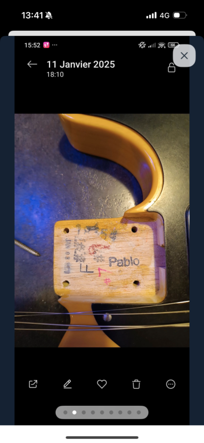

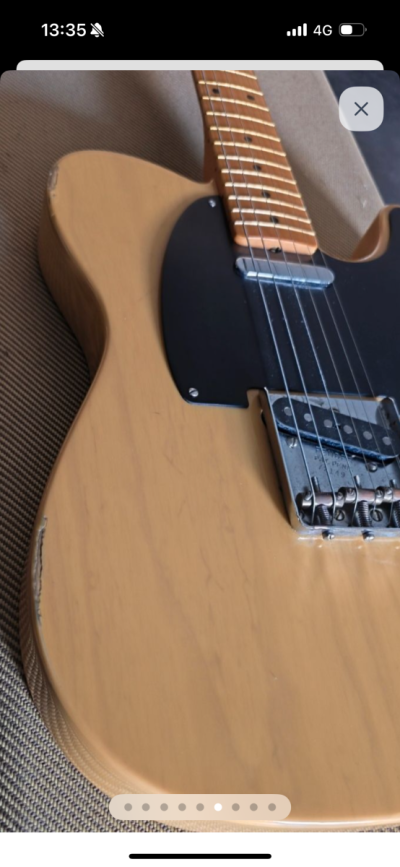

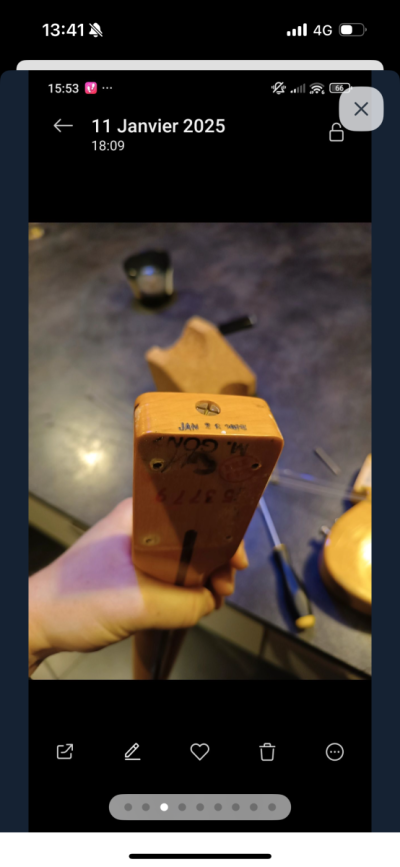

Hi !
I’m considering buying what seems to be an ‘03 AVRI ‘52 Telecaster reissue. Unfortunately the 5 digit serial # cannot be found on the Fender serial finder.
It’s a long drive from my house to go see it and potentially buy it so wanted to get some sort of approval from the good people at TDPRI !
The seller has kindly removed the neck to provide pictures…
Also, what kind of neck profile should I expect ?

I cannot clearly see the number on the bridge plate.
I do know that serial number reference resources can be imperfect.
I would type the number into your next post in this thread. Is that a serial no. or the patent number?
One of our resident experts will have good info for you.

I have an AVRI '52 I call "Uncle Sam", as it was made July 3, 2001, so it is fairly close in age to the guitar you are considering. It has what I would call a medium "C" type of profile. A very nice profile, I might add!

Thank you ! The serial number on the bridge plate is 72149
Tuxedo Poly
Dec 19, 2011
2,727
Merseyside UK
The part codes on the neck (53779) and in the neck pocket (18354) are correct as shown on RU Experienced images.
