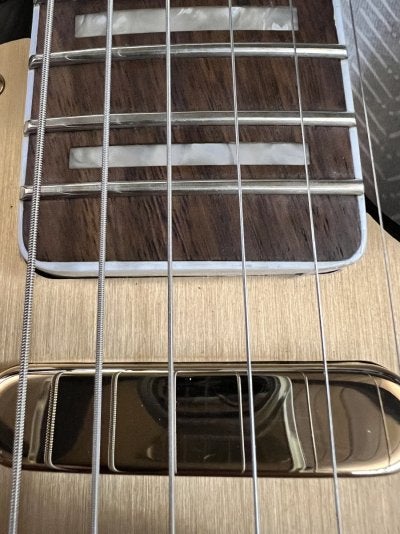

Hey guys! Been a while since I’ve been here and posted, but work and life’s been nuts! So I’m here again with a problem. I just brought this beautiful hunk a wood hole, and I’m getting wicked amounts of rattling and fret buzz on the low E, A, and D strings from frets 1-3. And the D string when played open sounds like a Sitar! Now I’ve loosened the truss rod, and it still seems not be giving ANY relief if any at all. And I’ve done probably 1-2 FULL turns added all up. I’ve also shimmed the neck, I have a piece of business card under the neck where the screws come through. I’ve also noticed that the strings are very much shifted to (looking up the neck from the bridge) left. Where the high E is almost off the board completely. Idk, am I better off contacting zzounds where I bought it? Or Squier themselves? Any help would be appreciated!

Just to double check, you turned it *counter-clockwise* to loosen the truss rod, correct? For fret buzz on the first 3 frets (not talking open strings), you are correct to assume too straight of a neck as being the cause. However another culprit would be frets that are lifting on either the 2nd, 3rd, or 4th fret. You should check for that. If you can slide your thinnest feeler gauge in there, you know you have lifting frets. It should be fairly obviously visually, or even just pressing down on the fretwire with your finger.
Sitar sound on the D String when played open, would be indicative of a poorly cut nut slot (string binding), or issues at the saddle where maybe the D string has caused an indent on the saddle material itself, and is not resting favorably. I'd check these 2 spots for discrepancies.
That string alignment issue looks to be caused by the nut as well, the high E seems way off to the right. You can try loosening the neck screws (1/4 turn only!) with the strings on and tuned to pitch, then re-tightening those neck screws, to help "sit" the neck better. Do note that this helps things further down the neck (15th fret onwards maybe?), but does not solve the iffy string spacing up top near the nut itself.
That makes me suspect a problem with the nut. I had a similar problem with my Epiphone SG Special and replacing the nut correct the problem.

As @Billy3 notes, your low E (wound) is wrapped above the "lock" wind. This decreases the break angle over the nut and can be a source of buzzing on any string. Increasing the break angle behind the nut and polishing your nut slots may help. Sloppy nuts are common with Squiers. They do not come fully set up, although some people can live with the factory set-up.

Definitely some points worth checking are:
- are the fret slots in the nut cut correctly? This is one of the main sources of sittaring, if the string does not lay correctly in the slot, that is cut.
- Is the nut spacing ok? It appears way too wide in the pictures,
- Same the bridge spacing.. do the strings fall off the fretboard at the end? You should have a 2+mm space left to the edge of the fretboard on each side
- the neck pocket is not cut really clean.. is it a squier body at all? Have you taken the neck off to check for any markings?

The high e is literally off the board by the time you get to the neck pup. At the nut maybe a strings width before it falls off. The rest of the strings feel right.

Graphite will do no harm, but it is not necessary if the nut is formed, set, and polished properly during a set-up.
Unless you do your own thorough, systematic set-ups, I would advise playing a new guitar for a week or so, letting it settle to it's new environment, noting any issues you don't like (action, buzzes, string gauge, etc.), tightening any obvious loose screws, then taking it to a GOOD tech, luthier, or friend who can do a proper, new-guitar set-up. It shouldn't be too expensive, and the tech should be able to identify any serious structural flaws in the geometry of the neck/body. He/she can also set your pickup heights to your preference, if you have any.
It is very likely this is all your instrument needs. But the set-up needs to be done in the proper sequence or things get confusing fast. Virtually NO guitars arrive properly set up, because in order to be properly set up, a tech needs to know how to set it up for the INDIVIDUAL who will be playing it. There IS no "general set up" that will work for everyone, but sometimes the do arrive "close enough" if the owner isn't very picky!🙂
