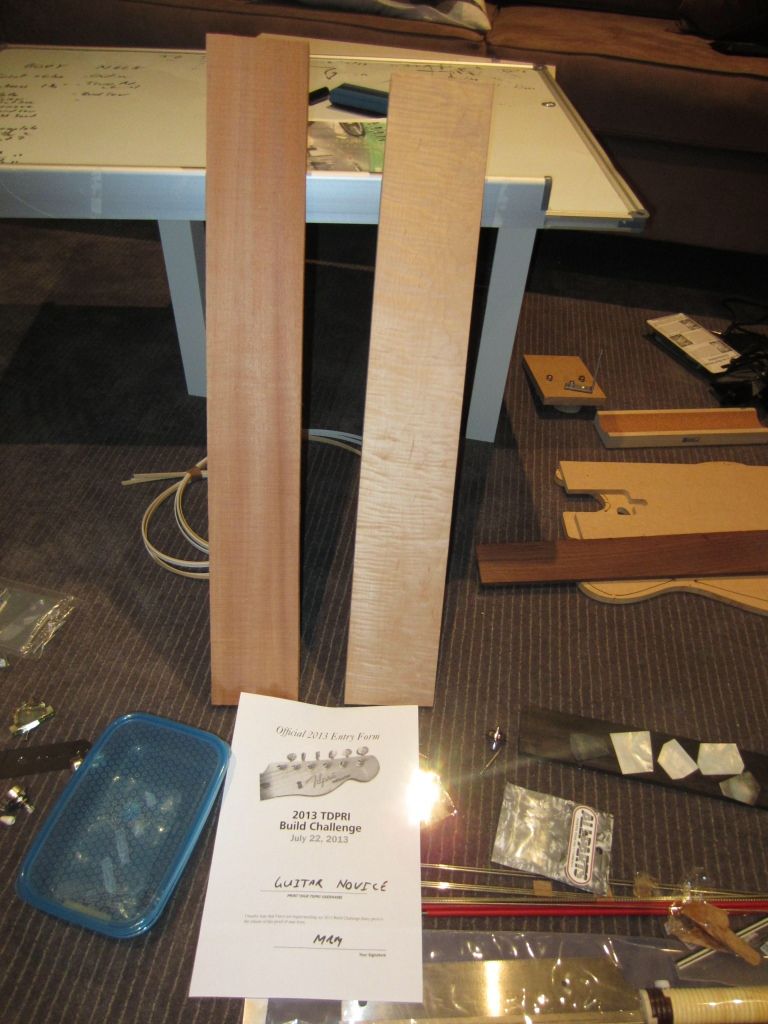

I decided to upgrade my neck blank to match the top i got. On short notice local luthier Perry Ormsby was kind enough to get one of his blanks. Nice figure on the blank. Photo does not do it justice.
New blank on right.
Also got some inlay. Its not cheap and i have no idea what to yet but will give it some thought.

Advice Needed - Fretboard markers
please go nuts with inlay process pix :)
So ive been thinking about this inlay process. Never done it before so don't want to overreach but I like my surfing so I was wanting to do something with that theme. Because i'm more autistic than artistic I need some advice.
I could use some surf logos. Maybe a picture of a wave.. bit like the one in the top left. Alternative is to draw some surfboards and use that as a fretboard markets. My ideal would be to have a sequence of a surfer on a wave showing him getting barrelled and coming out but I think that's just a pipedream.
Let me know your thoughts.
Cheers

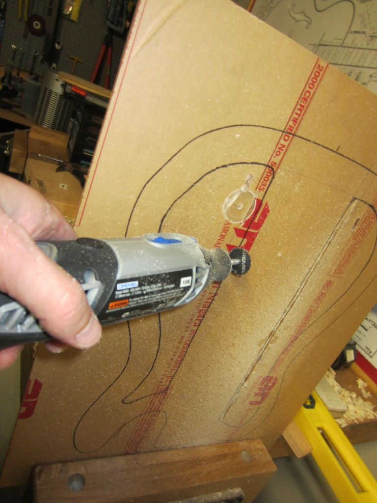

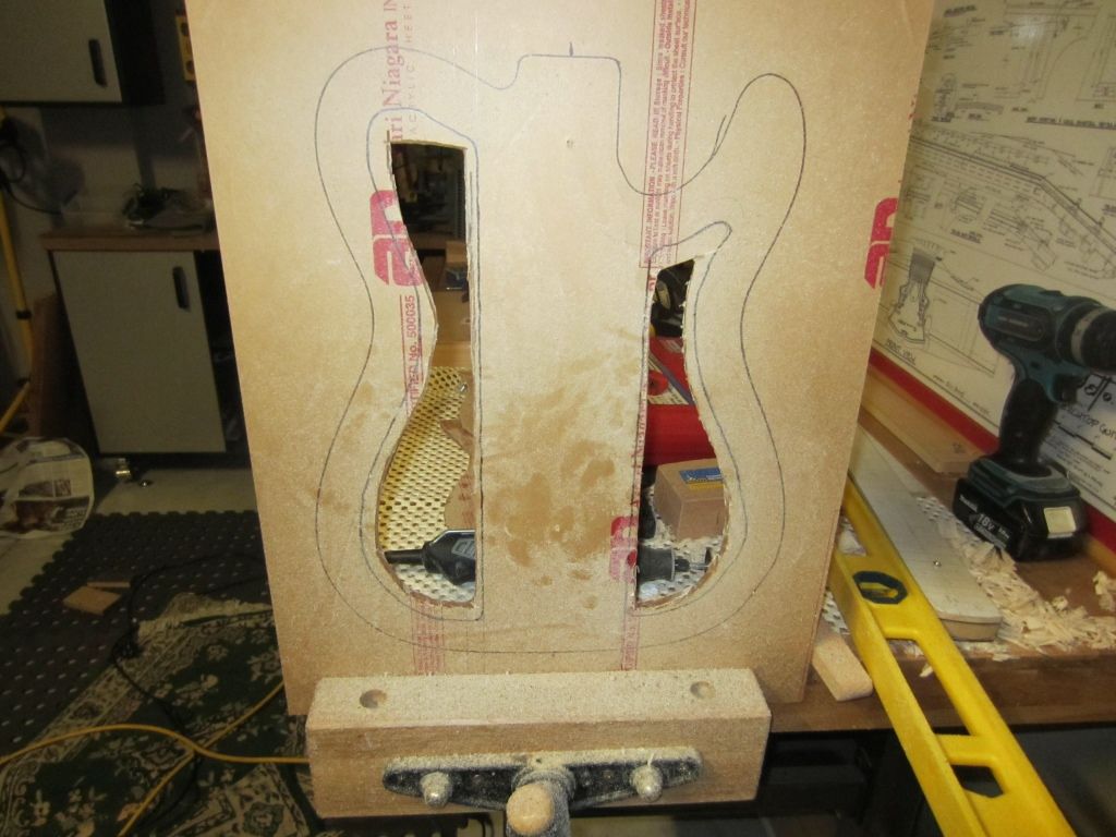

First step was to make a template for the internal contours. Got some plexi so time to give it a crack. I hand drew a 1 inch contour following outline of the tele.
Next measured 5 inches wide and 4 inches wide in the middle. 2 photos show the spacing of each. I think the 4 inch looks better.
Guitar novice
Feb 13, 2011
1,070
Perth
Cutting the middle out was a bit tricky. First tried a hacksaw blade. That took too long.
Next got the dremmel on to it. It worked but slaughtered the cutting disks.
WARNING. Put eye protection on. I could feel specks hit the face. I thought it was just plastic. I think it was bits of the cutting wheel. Btw. Fostner bit was not effective. See photo
This picture shows what size the cutting disk ended up as. Full size next to it.
Rough outline done but pretty rough.
Got the router on it. Much better. Its still a bit rough. Wondering how to get the lines a bit cleaner (i know it wont be seen but ill know). Hard to rout by hand.
