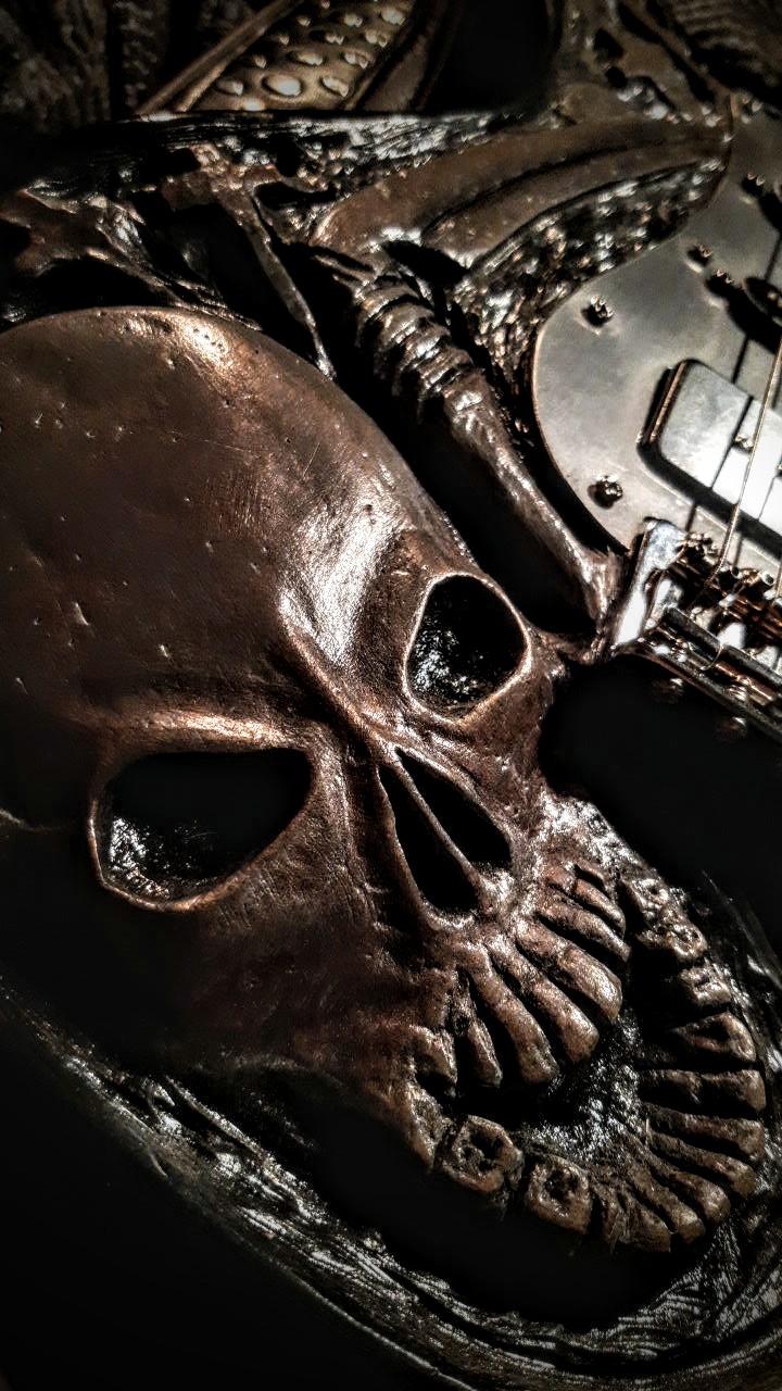

    if you are not afraid of taking a dremel to it, you can do some pretty fun things
