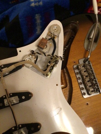

The pot is attached to a plate, that grounds all the other pots, same with a Strat, I think grounding they did in the 50s was cleaner, and worked just as well, with an old les Pual, it had no plate, so you see the ground buss wire running to all pots, buss wire and a plate is not needed. I like to keep things clean. The volume pot has all the pickup grounds, the trem ground runs directly to output jack, it’s how fender did it back in the day, works well, and looks clean.
just use the volume pot as a collection point for all grounds, it will work fine.

Chipss36 - nice wiring there mate. Thats what I like to see when I pull up a guard or control plate. Someone took the time to do a nice job. See it rarely in production guitars and it often looks like a bowl of spaghetti.

Ref. chips pic there...............Strats (normally) have shielding tape on the pickguard and THAT works just like the control plate on a tele (though not its real purpose, just a BONUS) and gives electrical continuity to everything there, metal that is.

thanks for the wiring complements, but I am really just copying what the fender girls in the 50s did, monkey see, monkey do….lol
