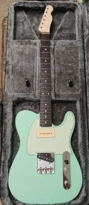

    Do you want to do two P90s, P90 in neck or bridge only, with humbucker, or with a Tele single coil?
    I built the one in my avatar using a Fender Performer body and an Allparts neck. It's using a Tone Rider Hot Classic Tele Bridge and a Guitar Madness (ebay pickup seller) Alnico 2 P90. Can't get much less expensive than this:
    http://rover.ebay.com/rover/1/711-5...0001&campid=5338148343&icep_item=274326722290
    I had to flip the wires on the P90 to make it RWRP with the bridge pickup and it was worth it. I now live on the two 2 pickup positions on the 4-way switch.

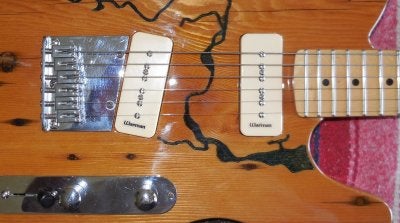

    I use Warman UK P90's.... RW/RP.... sound great and they're a good price... :)
