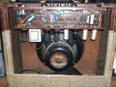

    I have a '56 that I replaced the P/S caps, but need to probably replace all the others, (behind the board!) Also the trem doesn't work, but other than "breathing", the amp sounds pretty good!
    (Pay no attention to the old Utah, it now has a Weber Alnico).

    Nice amp Bill. If you haven't already then try a new 6SQ7 tremolo tube. If that doesn't do it then I'd replace the three .05uF tremolo caps (lower left in schematic) and the .01uF tremolo filter cap. More than likely that will get it going. If you get a tremolo thump then replace the five .005uF caps in the "Tone Filter Network" (center left).

    I figure most of the caps should be replaced, but the board has to come out, and I think it will be a PITA! It had a new trem tube, and the old one in the box in the bottom of the cab when I got it.
