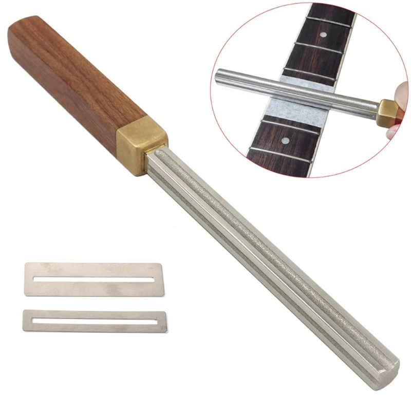

I surf AliExpress occasionally to see what kinda goofiness they have currently..
I just found this.. I ordered one .. I'll let ya know how it does.... but for 14 bux, and if you're only doing a couple of guitars it's hard to beat... they have a slightly different configuration for 3 bux, but I wouldn't trust a 3 dollar fret file for all the tea they have over there..

Let us know how it works! My biggest concern is that it is a little too wide, which makes rolling the file to create a proper profile (not just a crown) nearly impossible. But if you just want a decent crown, it looks like the "diamond-like" grit could work OK.

OK, i sed I'd report back.. sorry nothing to report except RUN AWAYYYYY .. this thing is a POS... and that's the best thing I can say about it...
live 'n learn... a $14.00 lesson....
at least you haven't spend it on coffee or something useful! ;)
Cheers and thanks for sharing!
I thought it looked very similar to one I bought last year and came to the same conclusion. :(

What did you not like about it, Ron?
the shaft is 3/8ths, or 10 mm.. just way too wide, with cheesy grooves that appear to be irregular... and the shaft is cast metal, it is not a nice machined piece...
Can't use it to crown frets. Can you use it to eat Cheetos?
the dawggone thing is so big it keeps mashin' 'em... I reckon you could poor some cream 'n cheese on the pile and make Cheeto Alfredo...
