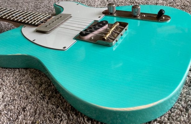

So I love Port Orford Cedar for guitar bodies. I found the local resale lumber yard selling decking grade port orford cedar in quanities I'd never seen, and I had to have some! Most of it went into making adirondack style chairs, but a couple of the boards were really high quality and a great weight so I decided to make a three piece tele body out of it.
I have always loved translucent surf green, so this is my first go at that color. I added a minimal ageing/relic kind of thing to the finish, to go with the ageing I did to the hardware, as I thought kind of a rusted ageing look went well with the surf ocean vibe.
I had a Seymour Duncan antiquity jazzmaster pickup hanging around, and I always thought that would be a good tele neck pickup. The bridge pickup I wound from Stewmac parts. They both sound great, though I need to wind the bridge just a bit hotter to match that neck.

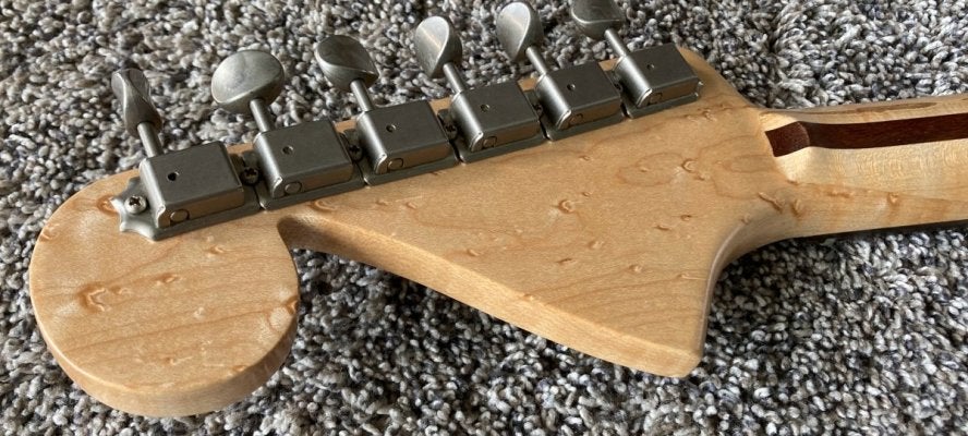

It's a light birdseye maple neck, laminated with some rosewood I had hanging around. I prefer scarf jointed and angled headstocks, so I went that way. I don't like string trees.
